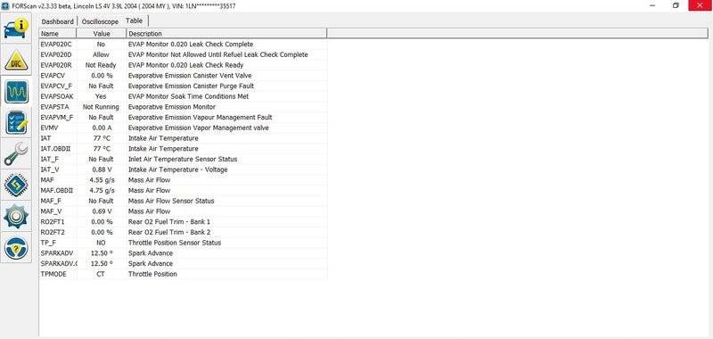

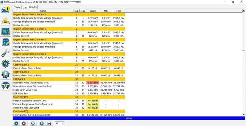

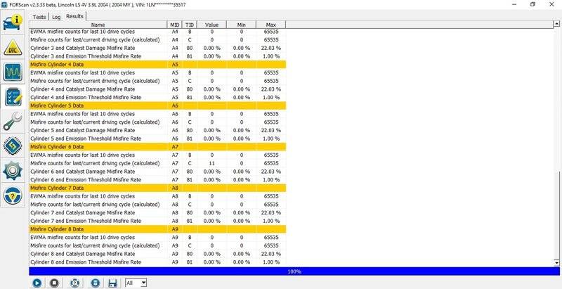

So, no misfires tonight. No DTC's in computer. Everything checks out.
Scanned my Evap, Emissions, and Fuel rail system. I dunno if there's something I missed, but if you guys want me to live scan anything or graph something, please let me know and I will do it and report back. Below is my results.
I appreciate the help fellas; If I can nip this phantom misfire in the bud i'd be so happy.

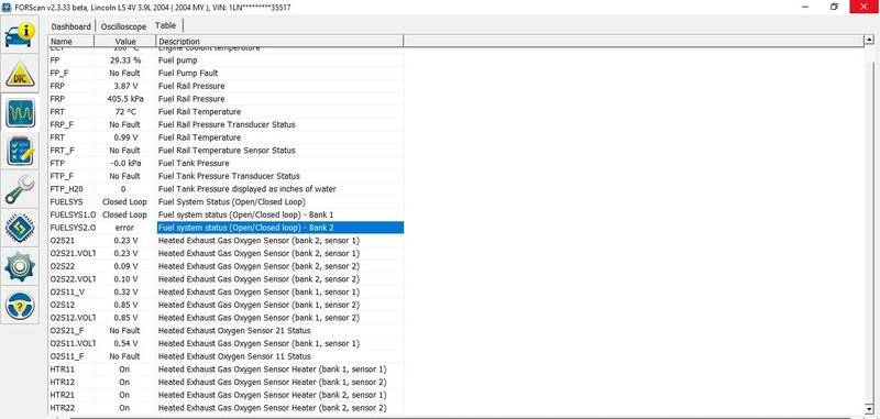

EDIT: I also scanned injectors for fault, No fault on all 8.

Anyone got any suggestions or tips? I would like to swap the injectors this week if that is likely the issue. Thanks

It misfires on startup (cold start). If I scan on cold start I will get misfire DTC on a random cylinder on Bank 2 - which I've replaced the ignition coils AND plugs on all the cylinders. Usually I will see misfire on Cyl 8, 6, or 5. And when I run the tune, and only with the tune, it goes into failsafe, but gives NO DTC's other than the DTC for failsafe.
That's what I'm battling.

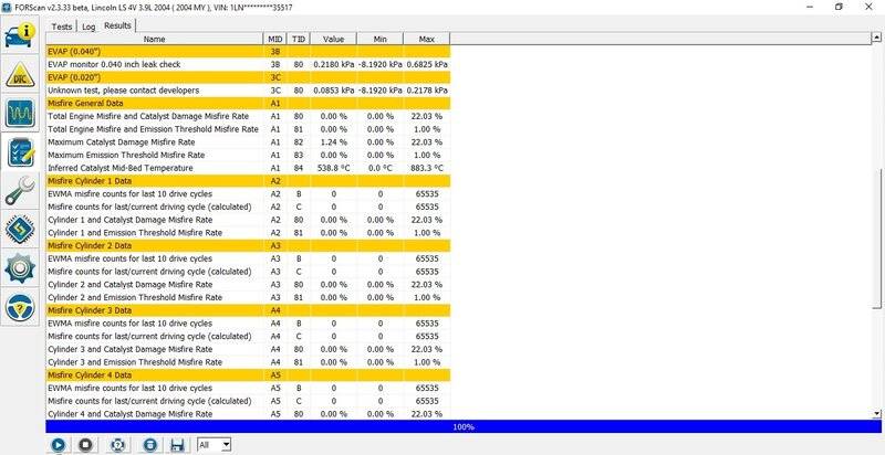

Something's going on with cylinder #6.
Ya, I gather those 11 misfire were on startup. I heard them when I turned it on. Thing is, notice it's only 11? On a 35 minute trip, it should be WAY more if it were PCM or coils. I heard like all 11 on startup. So the whole car warms up, and misfire stops.
Why?
And why does it failsafe with NO other DTC when the tune is on???? This is making me crazy.
Fwiw, after I did this scan, I swapped coils #6 with #5.
Tomorrow on a cold start, I'm gonna see if #5 misfires. If it's still #6 misfiring, then I'm duped.
My experience looking for marginal coils and such is that very low counts (3 or less even) do indicate a problem.
A problem? As in, either the coil itself is faulty or possibly PCM?
But if it's electrical (assuming), why does it go away when the vehicle warms up? I mean, if the PCM were damage due to bad coils, wouldn't it keep misfiring regardless of engine temp?
Some electrical things do improve with heat. Anyway, there's not enough info to say if this is electrical or mechanical, coil, plug, injector, crank sensor, air leak, or whatever. But at least you know a little more about where to look.

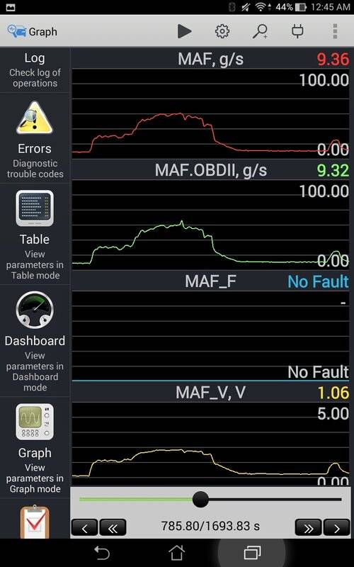

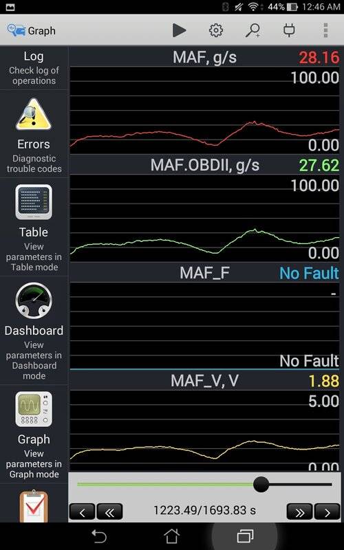

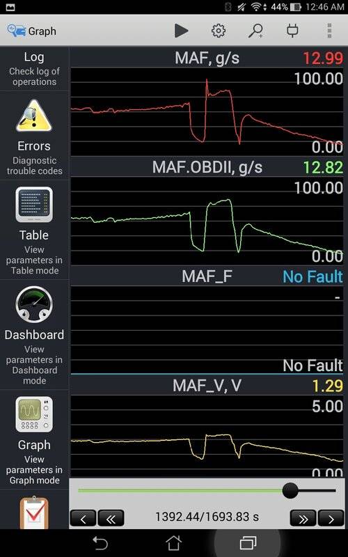

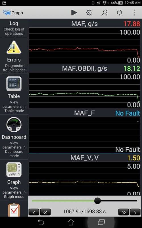

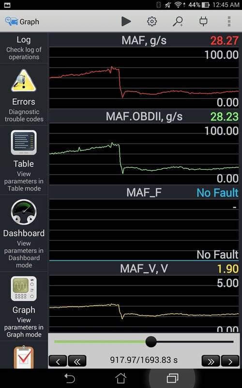

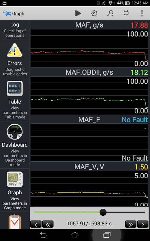

This is from my 30 minute drive home this evening. I saved the Live Time, but not sure how to upload the .FSL file, so I took screenshots. I used my tablet to log on the drive home.
Everything looks normal with your maf... Just wondering if you unplugged your MAF before turning car on and starting it? Any difference? I don't want to jump to conclusions of the bazaar but I wonder if the tune you downloaded has something to do with this cold start up misfire issue

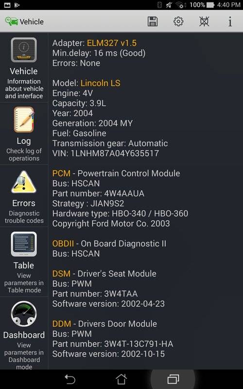

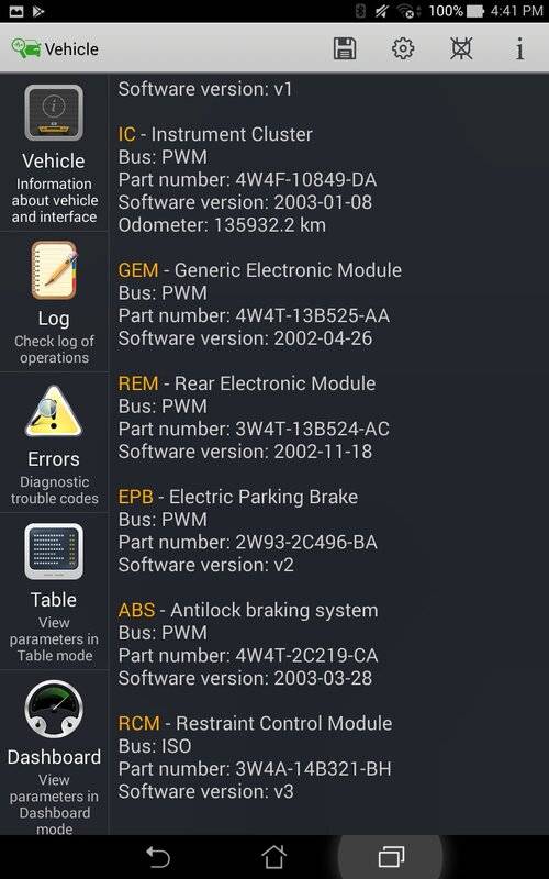

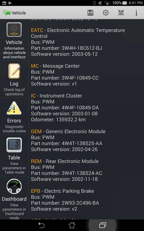

I took the liberty of taking screenshots while in there and here's all the modules for my LS. I don't see anything wrong in it, but here they are:
So, good news / bad news. It looks like it can, but needs data copied from the original module...
