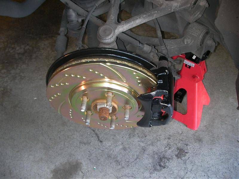

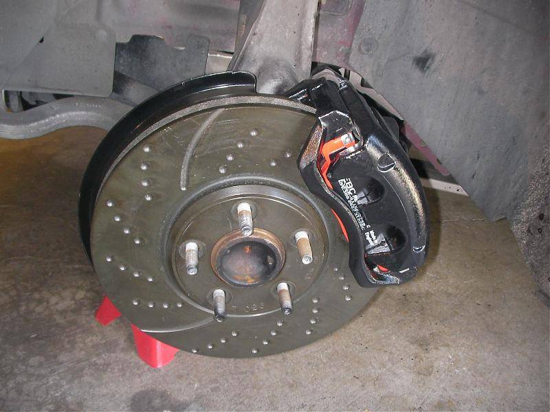

It is very easy. You need a 12mm socket, and end wrench, and a 15mm(?) set, of various std, and deep sockets. the upper bolt, for the brackets in the front are behind the spindle arm, and will require an extension.
Watch this, as the factory used copious amounts of thread lock, and it makes the bolts tight, all the way out.
