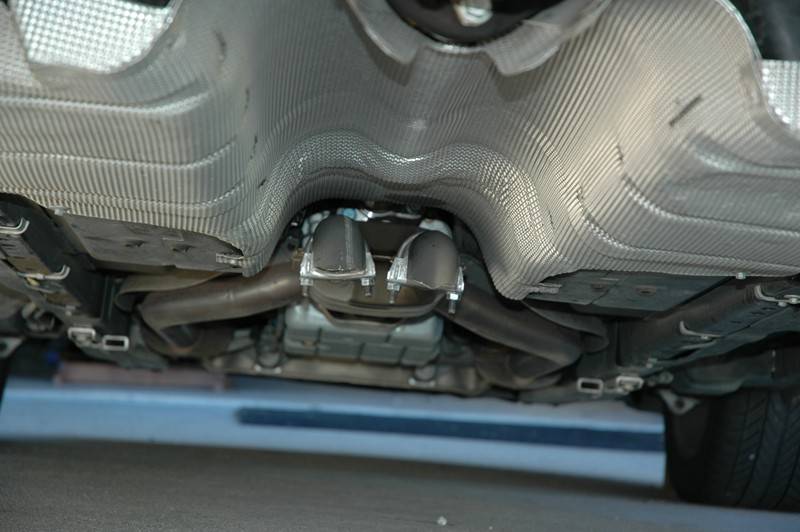

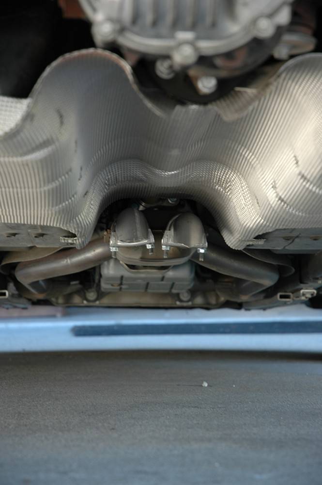

So today i removed my exhaust from the h-pipe back and made some turndowns... the sound is crazy really deep muscle sound. i was surprised to hear it when i first started the car, but hopefully ill get a video up so everyone who wanted to know what it would sound like can hear it.

SO what exactly did you do? Just cut the pipes after the H and put on those turn down deals?

BTW the undercarriage of your LS is VERY clean.
its loud very loud and without those turndowns it vibrates the hell out of the car. The sound was extremely shocking. my roommate who used to have a 69 cougar was shocked and wanted to know how much i had paid for the sound lol.

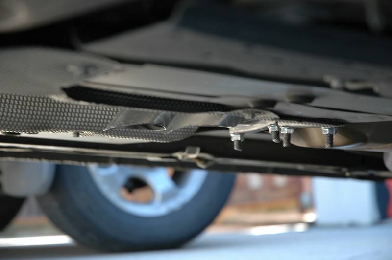

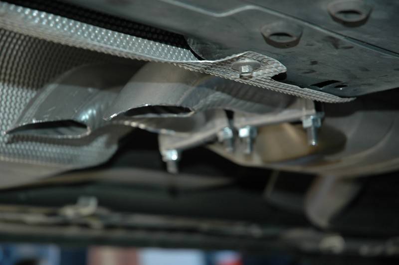

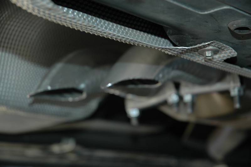

but there are two exhaust clamps that mate the pipes to the h-pipe and all you have to do is unbolt those and try and remove the damn rubber hangers that have metal inside them lol(found that out trying to cut them off) and its off. i did cut the two turndowns out of 45 degree 2 1/4 pipe that i got at the local autoparts store. they do have turndowns that they sell but they were sold out at the time. total cost was around $20.00.
