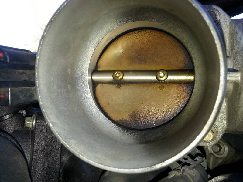

2) TB was pretty bad. (pic 1) Cleaned thoroughly with CRC TB cleaner

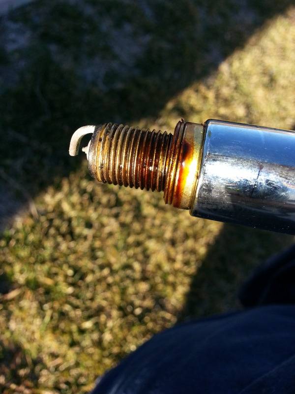

3) A few of the plugs were baked pretty good, and had a good bit of oil at the threads but not on the electrode or ceramic insulator (pic 2). No oil or moisture in wells at all (thank god). Btw I posted this earlier in this thread but the VCG's were replaced 18 months ago. The new gaskets are doing their job.

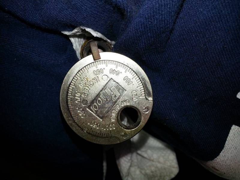

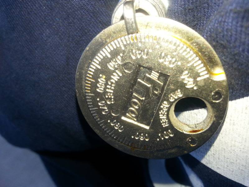

1) All the old plugs had a .048" to .054" gap (pic 3). New plugs were gapped properly at .041"

dirty throttle plate
old plug
old gap
new gap

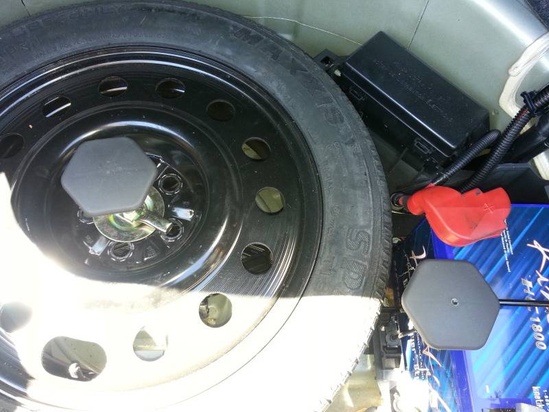

Yesterday I had some Michelin's put on the front wheels, and when the shop guy was putting my spare and jack back in the trunk, he noticed my battery was not secured with the bracket, and that was because the battery was the wrong size (too small). Anyways, he told me I should get it replaced with one of the right size. So anyways, getting a pretty serious audio system put together in the LS, I've had a new Kinetik AGM battery sitting in my garage with my other equipment for the past couple weeks and decided to install it this morning. Fits like a glove, a very tight glove. Upon starting after installation, I did not get any stuttering or rough idle I am used to. It may have been a fluke, but could this have been a voltage issue in any way?
The big plastic cap that you stuck on the end of the battery hold down actually goes on the end of the spare tire hold down. It's purpose is to give support to the middle of the trunk floor panel.
