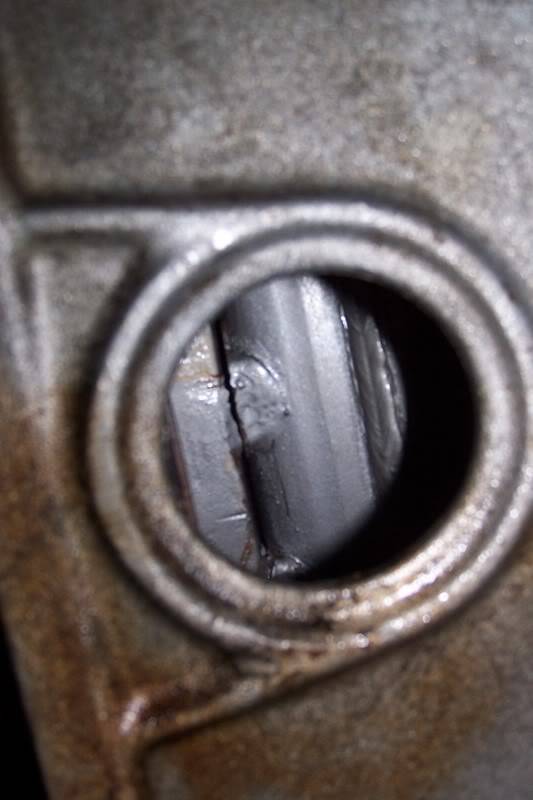

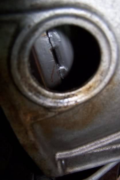

Well for the last three days, I thought my car was toast and started to try and sell parts of it, will I kept think 121000 is to young since I really dont beat on it, and I figured I look under the car for something loose, all bolt in the Tq where snug, so I presummed the worst, Then I noticed it would get louder or click faster or sometimes stop when i put in P or N or sometimes R but D is the worst, so I told my friend this and he was like " im giving my hopes up" so today I go a do one more look, I jack the car up and start I here the noise from the middle of the trans/motor so I removed the plug and notice the fly wheel it whobbling, so i check everything and nothing then I guess I got lucking a stoped the car at the right tome to notice this

Looks like the welds were poor quality on your edge torque converter...

ya the beads were bad, i mean look were it broke right on the edge(no pun intended) so it didnt even penatrat in the metal on the one side
Those are some pretty good photoss for a limited space... :rolleyes:
Actully the welds broke right through the center,... could there be anything off alignment?? :confused:
yes on one it broke a little more in the center but on the second the bead is still intact it looks to have been riped off
