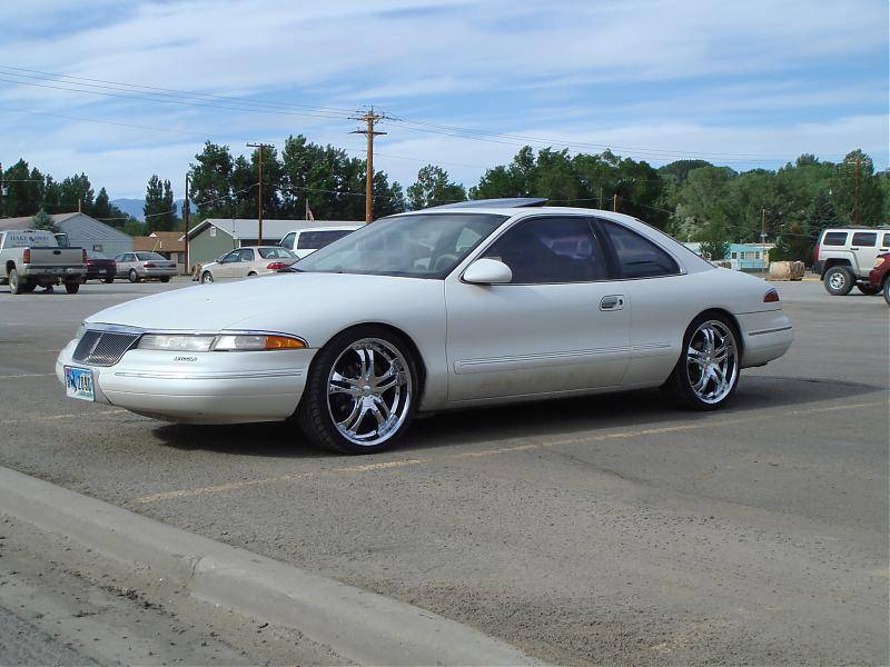

20s on a 245/35/20 is nearly identical in diameter to the stock 225/60/16s. as long as they are the correct width and offset you will not have any problems with rubbing.

i have some 22 inch gianna blitz on my mark with a positive offset of 38. and they are 8.5 inches wide. they ride great. better than my stock 10 spokes believe it or not. but it takes more effort to parrallel park, my speedometer is off by about 3 miles per hour, and watching out for potholes and car jackers is a bitch

you can fit a 40 series tire on a 20 on the mark with a 245 width if your willing to have your speedometer off a little bit
i had 225/35/19's and it rode like complete horse sh!t (bent wheels ect). Put on some 235/45/19 perelli rosso's and it was a heck of alot better..depending if your lowered or not, if you go 20's def dont get 35 series tires.
im lowered and dont have any issues with the new tire size. rims are 19x8.5 with a 47 offset but required a 8 mm spacer.
