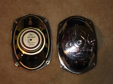

Here is a pic of the speakers im putting in. Quite a differnence from stock.
