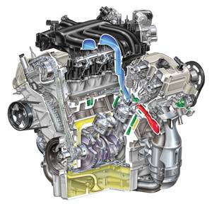

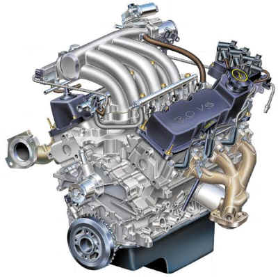

3.0 vulcan and 3.0 duratec have almost nothing in common.

One is an alien with green blood and pointy ears, one is a pushrod OHV and the other is a DOHC. They share nothing but the 60* V configuration and the number of cylinders (well, except for the green blooded hobgoblin:lol:).
