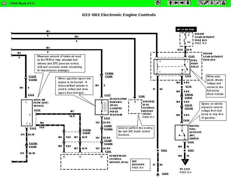

Here's a schematic. Check for voltage between pins 3 and 10 on the FPDM.

Thank you DLF. I will check it in the morning, after my wife has forgiven me enough for working on my car all day to turn the key while I check the voltage.:rolleyes:
Okey dokey. I have checked the voltage between 3 and 10 and there is nothing. Do I need to check anything else before I go to the junkyard and throw a part at it? What sends signal to the FPDM and which pins does it receive it at?

Check the output voltage of the IFS at pin 9 of the FPDM.
If there's 12v, then either the FPDM, the PCM, or the wiring between them is bad.
If there isn't, then check the input to the IFS and the IFS itself (it could be tripped).
Keep working back until you find the problem.
