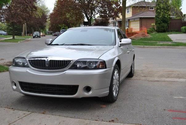

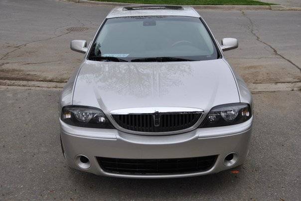

how hard was fitting the bumper on and taking the stock ls off? also thinking of doing a self mount

The bumper installation was the easiest part of this. It is held in by two bolts in each fender, and screws on the bottom attaching to the skid plate and wheel well liner.
Hella easy.
Did you have to take off the wheels to get the bumper off? It says you do in the lsk tech article. I haven't checked how it's mounted.
Yes you have to remove the wheels and get under the car. Just Jack stand the front and it is easy breezy.

Hey Drizz!! lol im just so happy right now just got my bumper back from paint (take pics in a sec) but question. My brackets for the fogs haven't come in yet but I want to mount the bumper so bad. Would it be wise to wait or can I apply the brackets later?
Yeah, I'd say so. It would be easier to mount them with it off, but you could do it while it's on. Might be a little tricky for some screws.
Well part o the bumper attaches via fog brackets. But I guess it will still work. It is not hard to installor remove. Pretty quick.

Not done yet, waiting for a bunch of parts and started to prep for paint( grille,lower valances and light buckets ) waiting for my brackets,fogs and chrome insert. Really considering lowering it now ..but fear the winter
Question...where should I mount the lic plate...dont want to drill the bumper
