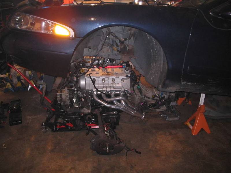

I used SUV jacks and jack stands, went slowly, used leverage, and a ATV jack to move around the K-member, engine and trans. and I did it all by myself in my garage. with no access to rafters.
I've never pulled a Mark VIII motor, but I pulled the Northstar out of my Eldo through the bottom. I lifted the car up using the front bumper supports, a beefy tow strap, and an engine hoist that was bought from a bus company (used to pull bus motors before I got ahold of it.
If you have a cherry picker just hoo it to the bumper support and hoist the car up, keep going till the motor slides out.
