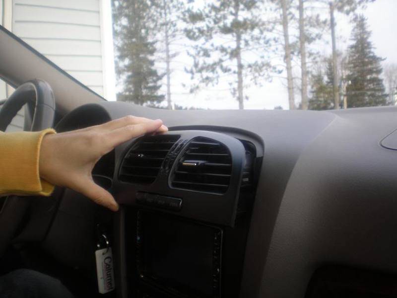

theres a clip on each side in the vent, you gotta use something flat to push in and pull it out.

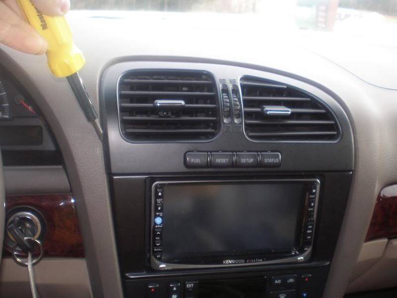

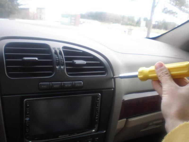

1. Pry carefully on the sides of the center vents above the stock head unit with a flathead screwdriver:
Vents will slide straight out like so:

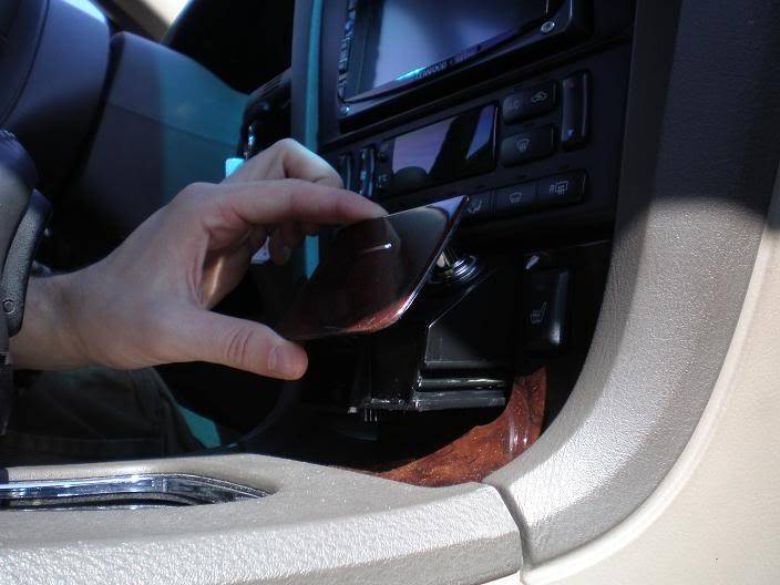

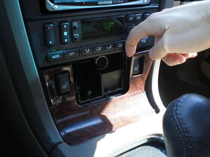

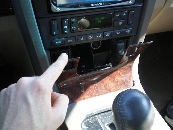

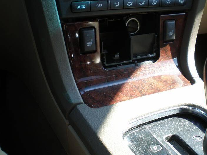

2. remove ashtray and surround:

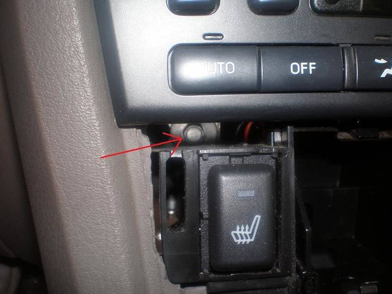

3. Remove the four bolts holding the head unit/climate control bracket in place. IIRC, it was an 8mm socket:
