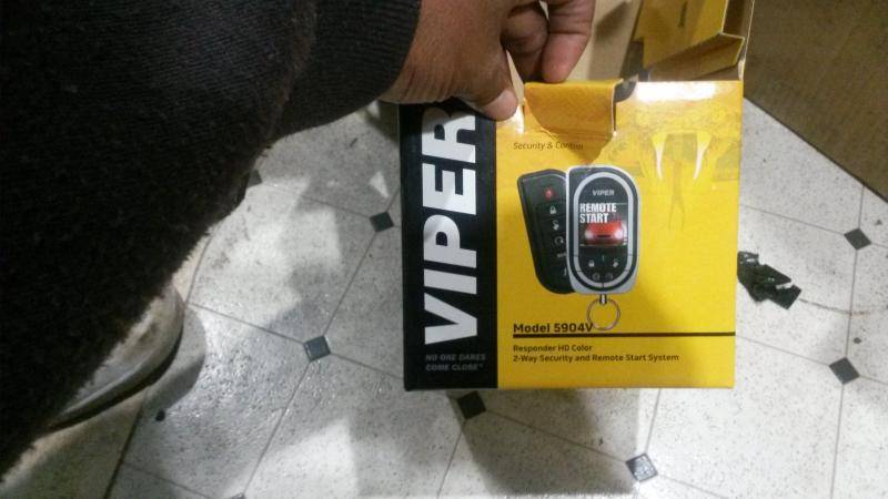

I put this one on my 90 Mark 7 LSC. Viper 5904V works great.
