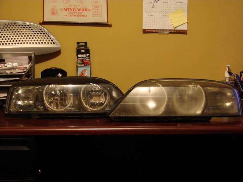

Quick close up of what i have so far:
Top one used to look just like the bottom one.

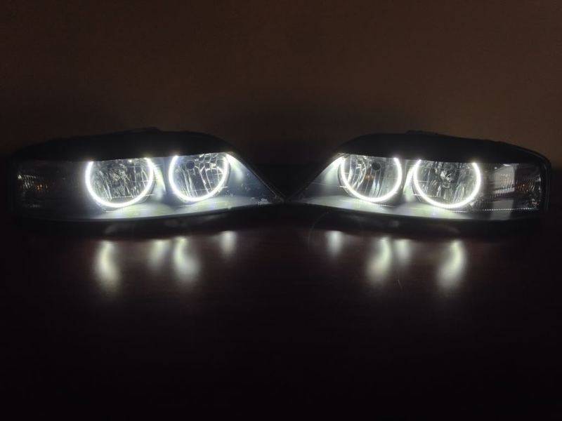

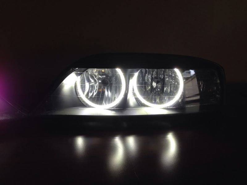

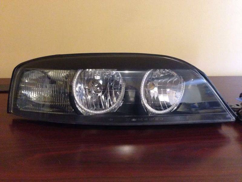

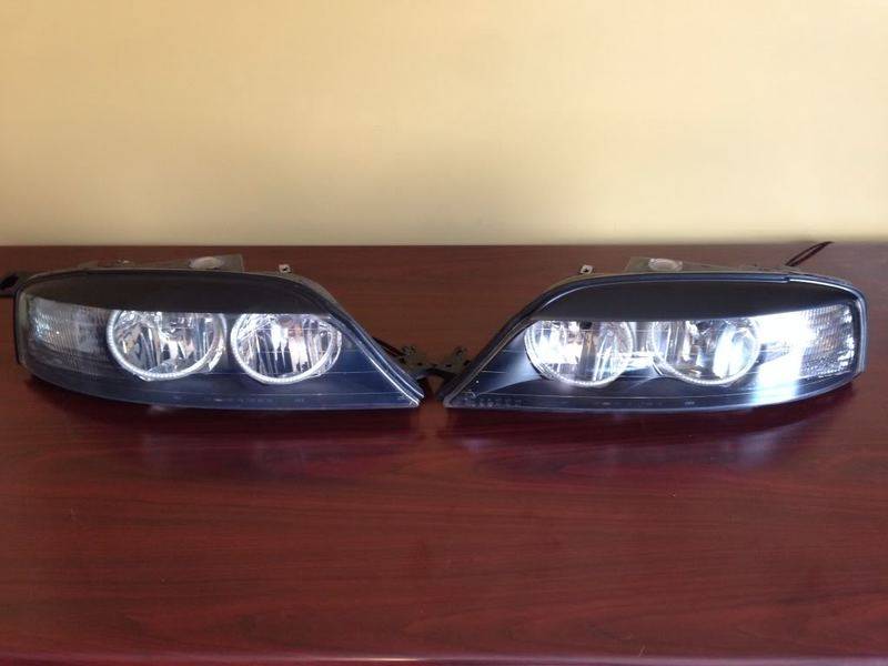

Done! And officially for sale...

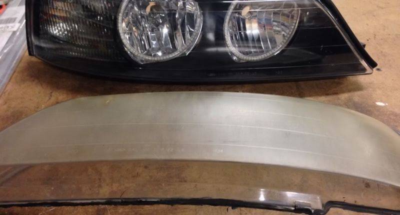

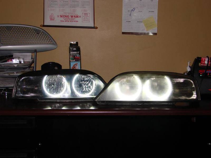

Before(left already restored):

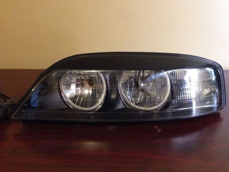

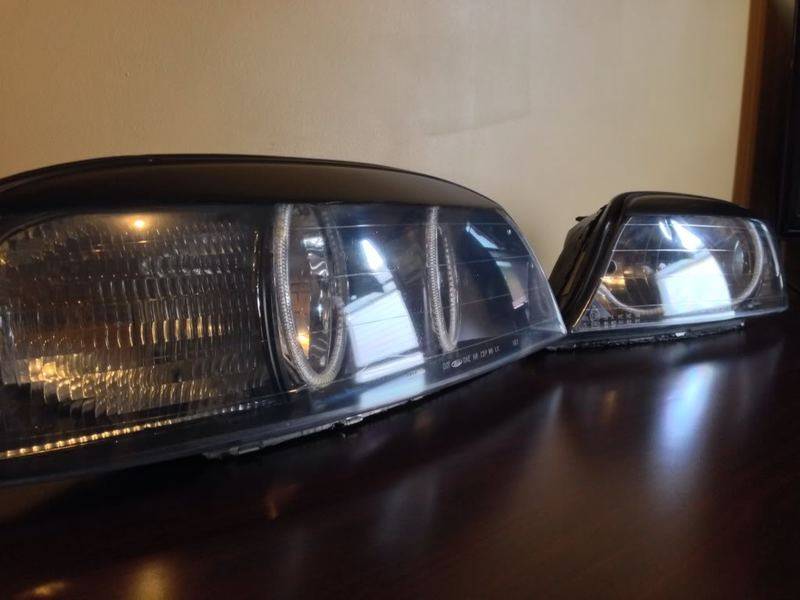

After:
Messed up the brows a bit but eeh its plasti dip.

every headlight in this thread are just OEM lights that have been modified...
for instance, the ones on this page are just normal 1st gen lights that have had halos/angel eyes put in, the amber lense replaced with clear ones, and have had "eyebrows" put/painted on the top edge of the light.
