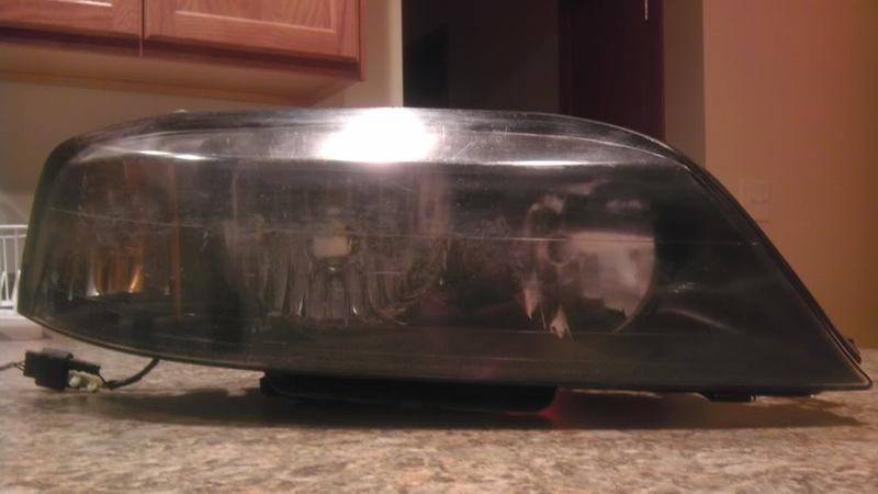

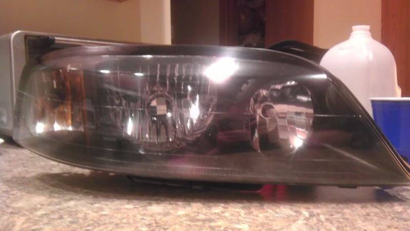

Before:
Was severely oxidized with writing on the lens in yellow marker. Whatever marker was used it wasn't easy to get off.

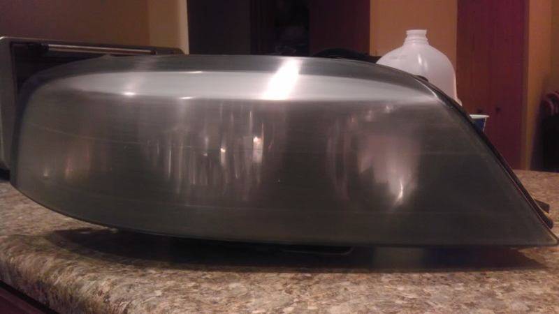

These pics were taken in progression wet sanding by hand. After:
800 Grit:
1000 Grit:

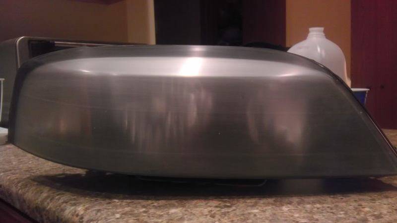

1500 Grit:

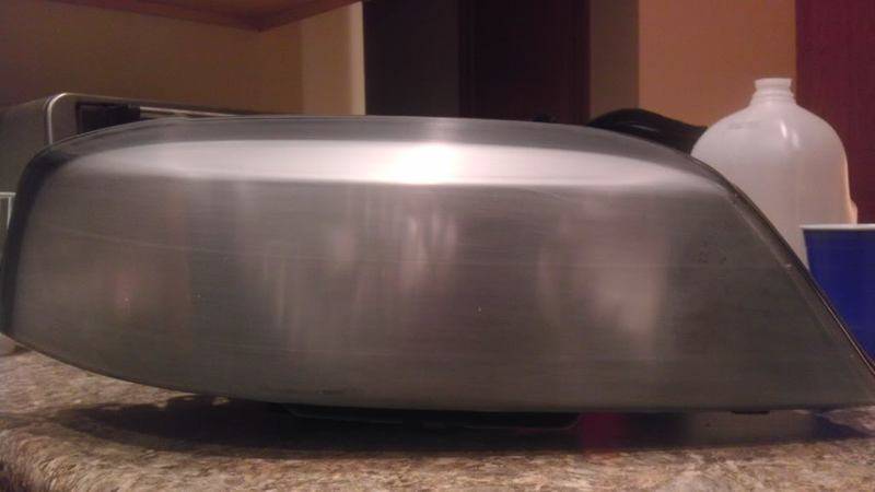

2000 Grit:
3000 Grit (Like wet sanding with a sponge at this point):

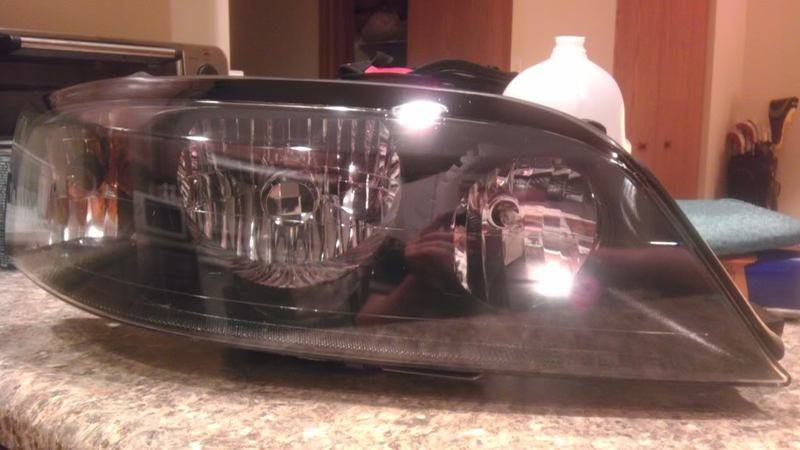

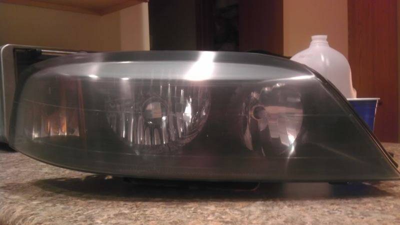

Finished product:

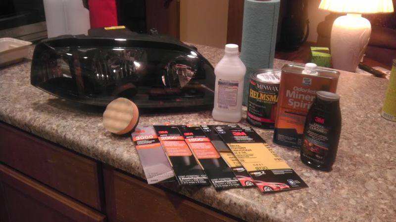

Materials used:

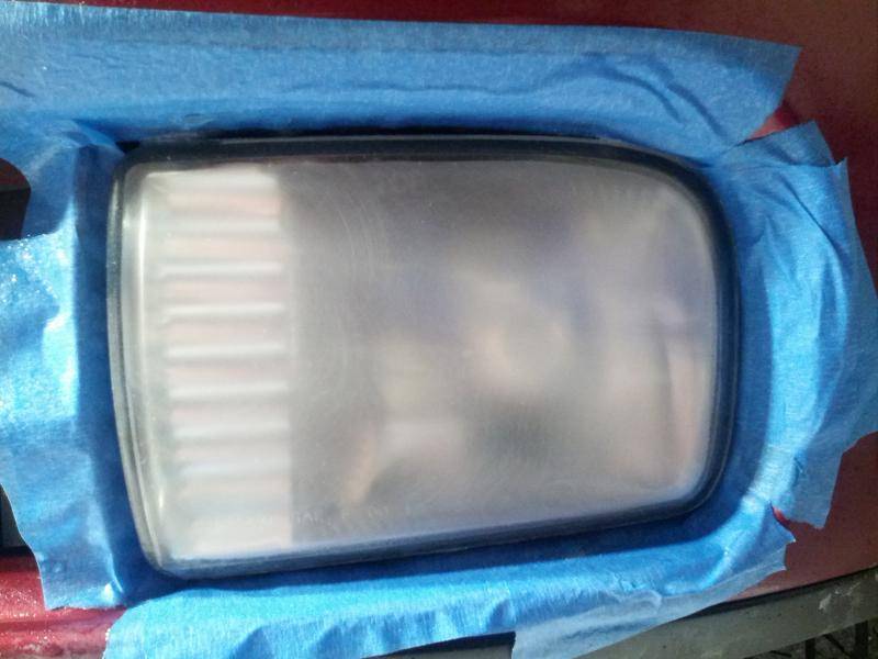

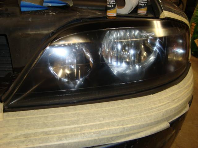

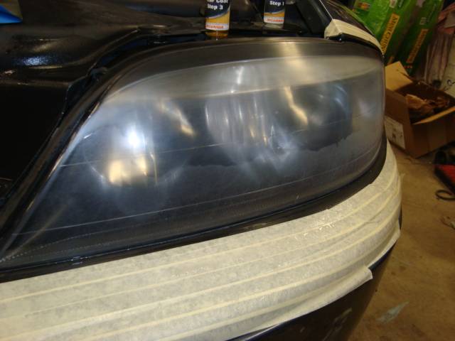

Did this tonight, picked up a mini kit from Sylvania at AutoZone when I went out for some hand cleaner. Surprisingly it's almost like they read this thread and just packaged everything in one little box. My only gripe was the factory UV coat took a lot of work to get rid of completely. I did mine on the car, the box even included half a roll of electrical tape to put around the lamp fixture.
Before
UV coating 'waterfall' that I had to sand out
Done
Needless to say, the car looks 5 years younger, amazing stuff.

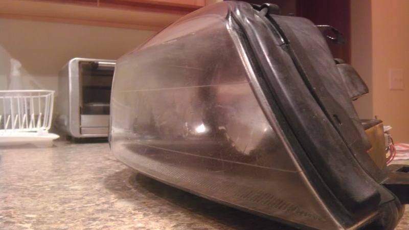

Well I drive a main highway 5 days a week for the last 3+ years and my lights were beat to crap. There were stone pits and they were faded pretty bad. In fact, they were so bad my mechanic said he almost didn't pass them for inspection cuz the light output was so greatly affected.
I used some sanding stuff I already had and bought the 3m headlight restore kit. The first light I did came out ok and the second light I did came out great. I figure sometime this summer I'll redo them again and get em perfect...This is a learning experience for me.
I looked online and found that a "regular" uv sealant probably wouldn't work too well since I'm essentially sanding ALL sealant off. I read that most stuff you buy at an auto parts store mostly seals "newer" lights that already have existing UV protection. I made a 50/50 mix of minwax and mineral spirits to seal (recommended by some people online)....we'll see how it holds up. IF ANYONE WANTS A WRITE-UP INCLUDING THE SANDPAPER GRITS I STARTED AND ENDED WITH, PLEASE LET ME KNOW.
In the first pic you can see the difference between the lights. Yes, the light on the right is clean....
Btw, cost me a total of 50 bucks or so.

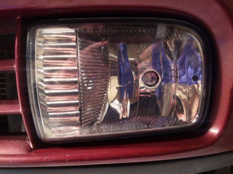

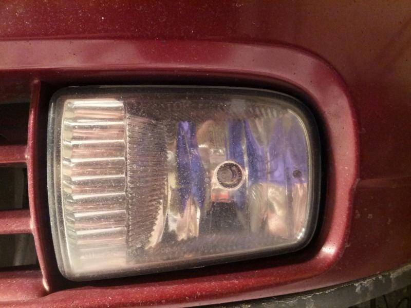

Thank you MyFirstLincoln for the instructions. Tried my fog lights tonight with the 3M Headlight Restoration and they worked out great. Picking up the spar ureathane this weekend and will finish up. This is with the 500, 800 and 3000 grit and orange buffing pad.
