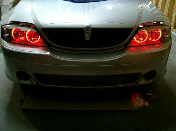

tada!
btw the CCFL red angel eyes will bleed into the lenses even when turned off...so hopefully you got the LEDs though I haven't seen the LEDs in person to tell if they bleed or not...but take pix since I will be putting red ones in my silver LS once I know they don't bleed
that's the CCFLs you are gonna get problems galor with them such as bleeding light, they malfunction in cold weather, and they often burn out which is a pain to get into the headlights repeatedly....
