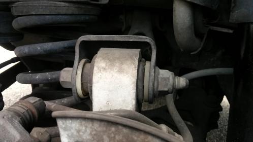

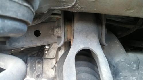

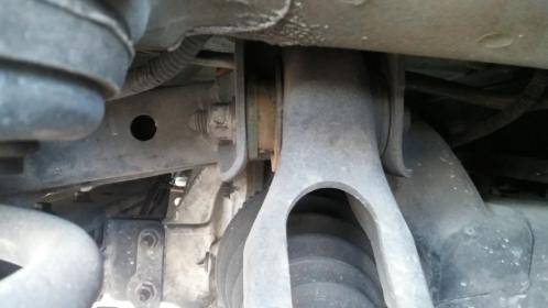

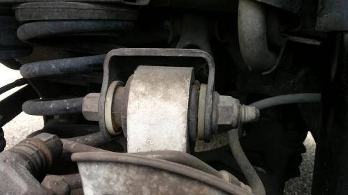

Ok so, my car does the worm when I hit a bump. Jacked it up today finally and checked the rear. I can move the control arm in and out by hand. Upper control arm bushings appear to be shot completely. I've never dealt with suspension so I'm confused on what I need.
Is it upper control arm to knuckle and then to frame that I need? Do you make those?
Pics below...
To knuckle
To frame
If you're able to move the UCA in and out by hand, you need to replace the bushing at the subframe end of the UCA. See the notes on that in the original post.
Yeah I read it very carefully about the MOOG brand having the flawed design issue. I ended up ordering from SuperCoupePerformance to ensure I got the proper ones. I went ahead and ordered the ones to knuckle as well, just to do it while I was in there.
