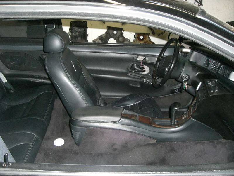

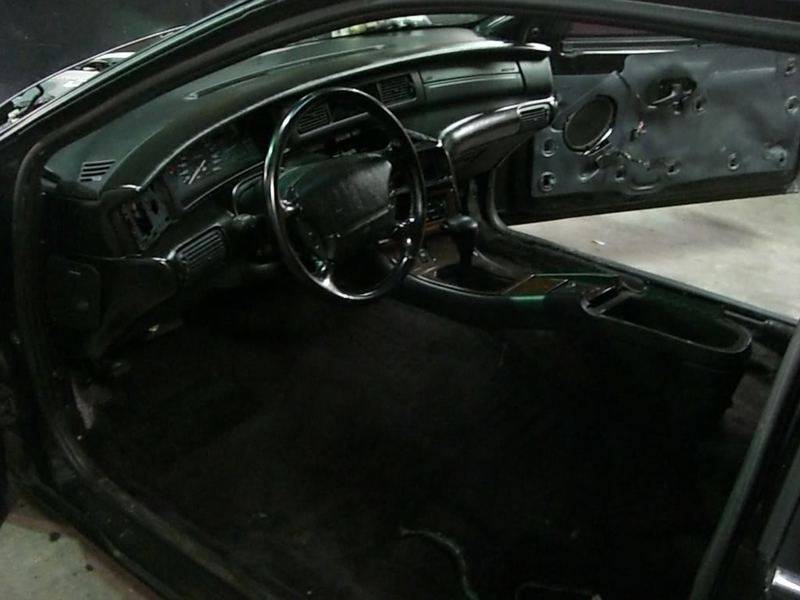

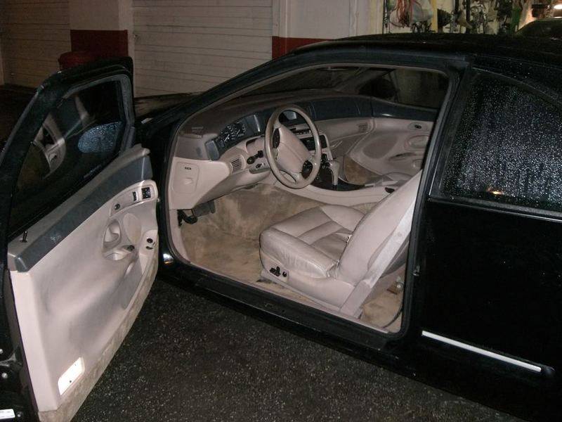

when i did my swap from mocha interior to black in my 93 i reused the mocha steering wheel, sanded it with 320 got it nice and smooth and then put a few coats of semi gloss black vinyl dye in a can from autozone, holding up superb!!!
old color:
after spraying it with dye:
it looks much blacker than the rest of the interior, but once i was done with the swap i hit everything with a magic eraser and the conditioned the seats and armorall'd the rest and it looks fine.
