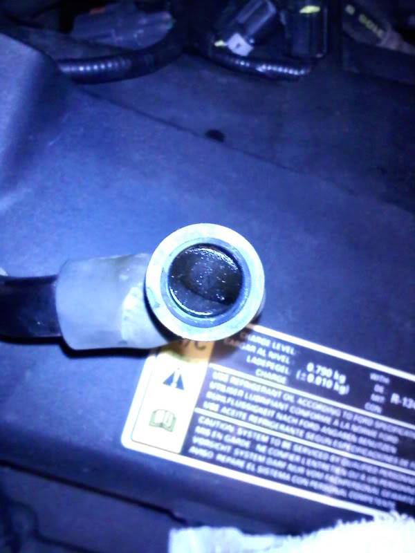

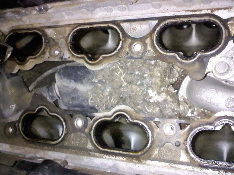

In this first picture there's three things to notice. First is what looks like a rats nest right in the center. Second is the black crap in the intake runners on the back cylinders, its nasty in the upper intake too and is wet with oil. Third is notice that that black is more is some cylinders then others, I'm thinking maybe the fuel injectors are not working as well in those cylinders?

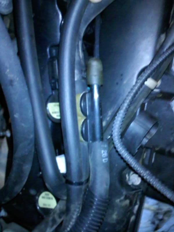

The second and third pictures are of my PCV elbow. It's collapsed and cracking but it's holding a vacuum.

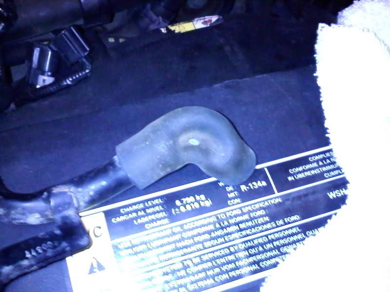

The forth picture has a vacuum check valve that I think may be bad. It's not holding a vacuum between the intake tube and the manifold vacuum port, does anyone know if this is normal?

Injectors: I wouldn't have removed them. Now you need to replace all the o-rings. There really isn't any need to clean or rebuild them, from what I have seen.
Gunk: That's not from the injectors, it's from the crankcase. It could be excessive blow-by due to worn rings. A good cleaning of the intake manifold and valves with SeaFoam or similar might be a good idea.

What about the line that returns to the intake tube? Right now, engine cold and off it's an open loop from the manifold vacuum to the intake tube line basically allowing air to go from in front of the TB to behind the TB, is that normal?
AFAIK, yes, that is the way it is designed.
Taurus's and other fords have this check valve setup, there is a small bleed hole designed in it. It actually bleeds off a little vacuum going to booster, why who knows but that is the way it is suppose to work. it works fine cause cause it goes after maf so it is still a closed loop. That elbow you definitely need get it at a ford dealer or this max guy on here. Oh and as the PCV valve, do yourself a favor and get a FORD OEM pcv valve, they are not all created equal. I have fixed many cars for weird idle problems and noises with aftermarket junk pcv valves.

Taurus's and other fords have this check valve setup, there is a small bleed hole designed in it. It actually bleeds off a little vacuum going to booster, why who knows but that is the way it is suppose to work. it works fine cause cause it goes after maf so it is still a closed loop. That elbow you definitely need get it at a ford dealer or this max guy on here..
