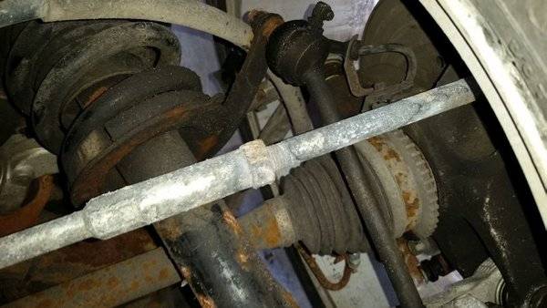

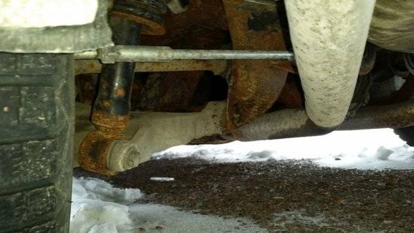

RigsLs, How are the bare metal rear adjustlinks holding up with the snow and salt? thanks
I'll grab a pic today or tomorrow. Probably a little rusted I'd imagine. I did hit them with some clear rattle can, we'll see how well that did.

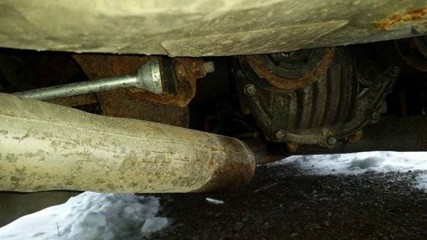

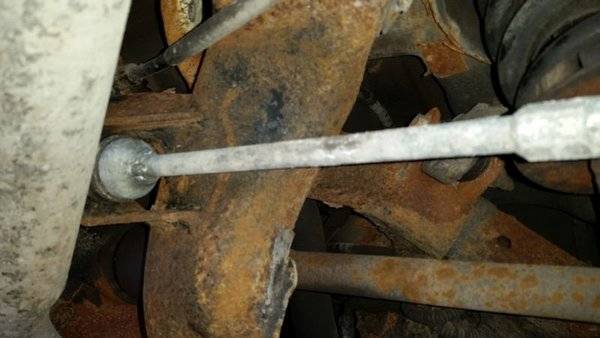

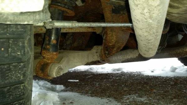

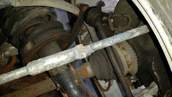

Here MONTE, quick and dirty. Please don't mind the Canadian rust in the background on this poor '04 LSE. (unlike my 01 Sport)
As you can see, they are holding up somewhat good after nearly a year (roughly)
Two things to consider:
1) I had covered them after install with some clear coat.
2) It's not a DD, it gets out only now and then but does see the Winter muck.
pics ...
Also note: (not making excuses) Toe Adjust Links are mostly covered in white'ish road salt.

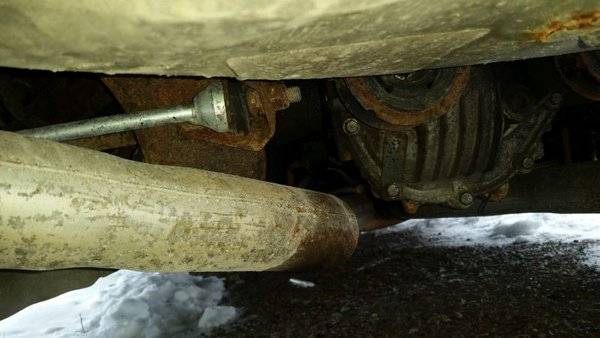

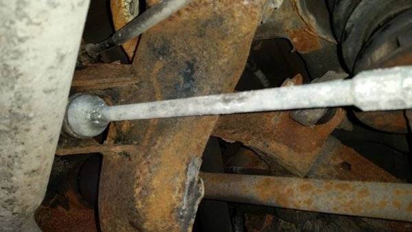

pics ...
Thank you RigLs
NP ... should have wiped them down first as they're clearly covered with winter muck.
I put new OEM passive s on my wife's '03 around that same time and DEEZA's non passive on my '01 4 years ago ... see if I can grab some clean pics of those when I get back home.
