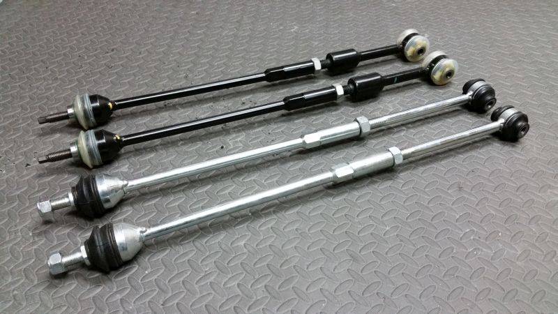

Deeza JA-L607 Non-Passive Steering Rear Toe Adjust Linkages are no longer available.
Black set is OEM w/ Passive-Steer dampener,
other metal set is the non-passive steering JAG aftermarket sourced from the UK for my 04 LSE.
i used the same non passive units noted above, and couldn't be happier to delete the rear steering :)

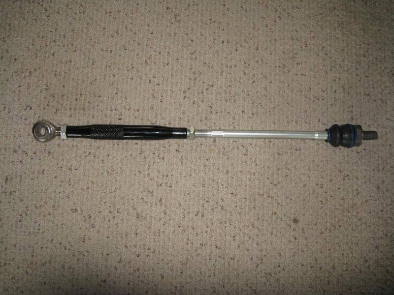

I am making an order of custom tie rod tubes that I used to assemble a custom pair of toe rods. I've been running my first set on my car for over a year and they have worked out very well. Recently, another forum member contacted me about them because he wants to build up a set. I will have 3 extra pairs of the tie rod tubes, if anyone else is interested in building up a pair for their car. They are stiffer, and you don't have to worry as much about rotting plastic covers. I am not in the business of selling parts, and can provide or post the details. All the parts other than the tie rod tube are off-the shelf. There are some minor parts mods to make them fit, so you need some handyman skills.
Could you tell me what I would need to do to assemble these? and do they completely replace these toe links on the rear of the car?
tijoe, are you not worried about rust, corrosion, or abrasion on the outer end?
Rod end has a chromoly body, self lubricating nylon/ptfe self sealing race, and hard chrome plated ball. No sign yet of corrosion.
If you are paranoid or drive you car in snow with rock salt or mag chloride on the road, rubber boots exist for covering the rod end. One can get stainless steel rod ends that wont corrode, but they are not as strong.
If something happens to the rod end, just purchase another one. Very easy to swap versus the stock toe rods.
