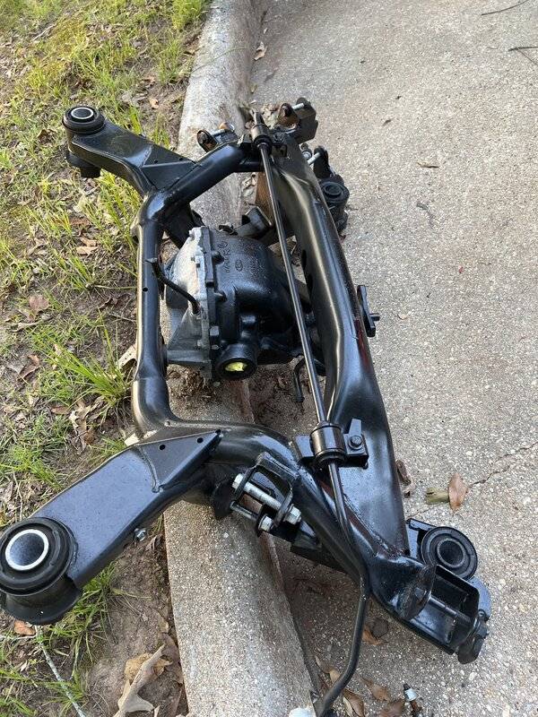

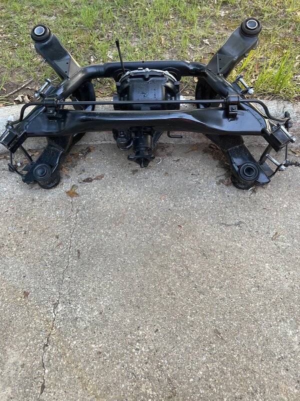

Not sure if this is relevant what you are talking about or needing but I have this gem here it’s brand new (7miles on it I believe) been garage kept til last week I had to move it out on driveway. I was about to remove the differential and sell it and the subframe separately if this is something you are in market for let me kno before I list it.

I have some used control arms as well. And axles rotors brakes etc. but this piece is brand new, my understanding is their was a truckload being delivered and hauler got in wreck and all the cars were salvaged. It has the 3.31 rearmed if not mistaken. I drained the fluid and sealed the holes off
