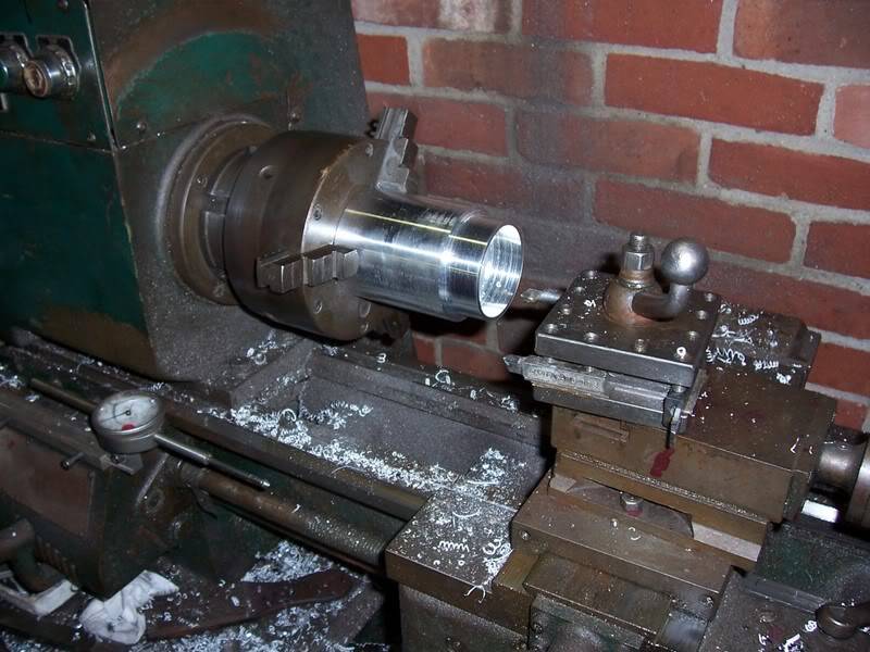

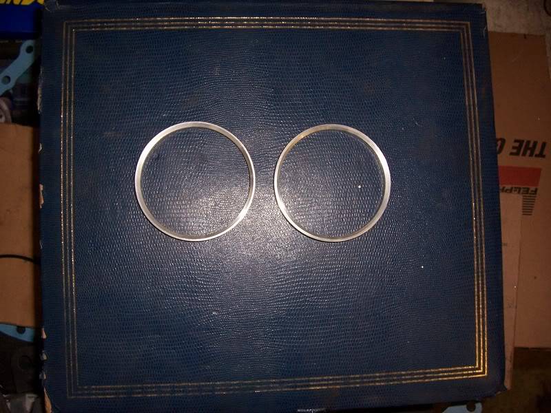

Now on to the rear. I found the rear caliper to met my needs and no need to change just paint black. I did find that I had to make concentric rings for the rotor to hub.Here they are being made on the lathe.
Ok I'm going to have to make a disclaimer here because this is my car and I work on it how I please. This write up does not imply that this is the only way to do this or the best way.Just way I did it. That said,on we go.
Here they are done.

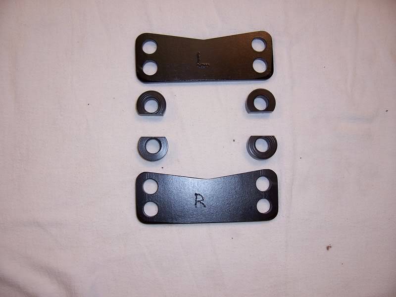

I also made the new taller caliper mount plate kit so rotor won't hit the caliper.
The caliper plates and concentric ring mocked up.

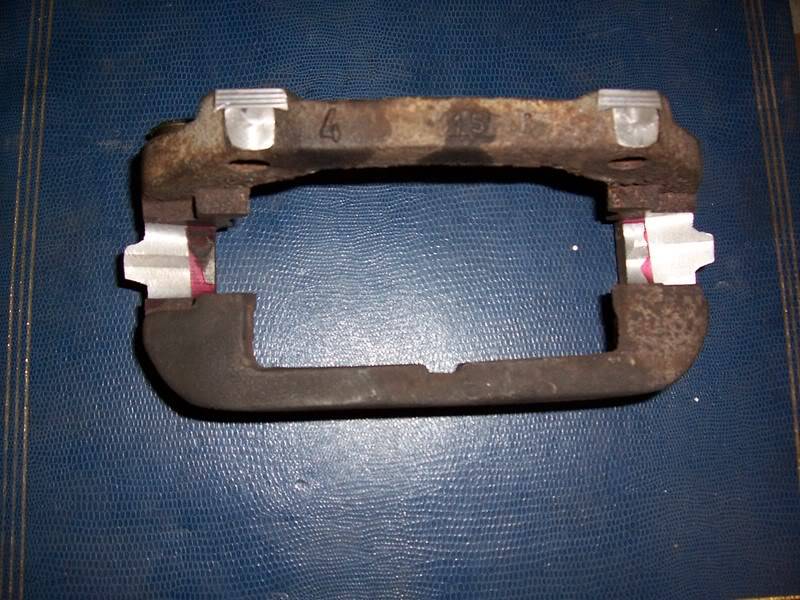

You also have to clearance the caliper mount for the rotors O.D. Don't go to deep because you'll break into the pin slide area and you dont't want junk getting in there.
This is the new stuff.

how did you add the needed clearance on the caliper bracket?
like in this pic:
Milling machine IE Bridgeport. I was like wow whats this doing up here. LOL There was alotta number crunching and planning to get these where I wanted them.
