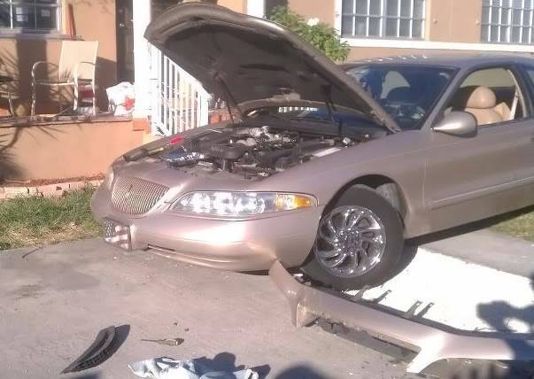

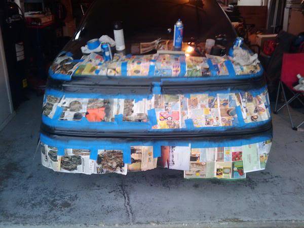

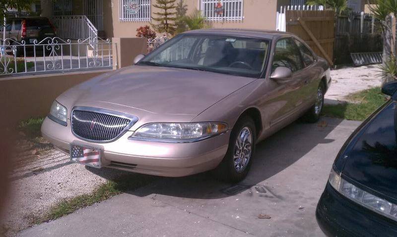

Yeah, color match those parts to the car! It's the best way out & your car looks like an LSC. I just had a very minor accident but it ruined my headerpanel. I was lucky enough to find one with original paint, when I swapped it I took advantage of the dis-assembly & painted the parts to match the car. I'm good with the spray can so I did it myself. However it's a super cheap job if you take it to the body shop. I promise it will look so much cleaner & much cheaper than re-chroming.
BEFORE:
AFTER
I assume you're good at the rattle can because you do it alot? LOL i see overspray on the driveway next the the wheel on your 1st pic..was that a center console shifter surround piece?? haha

LMFAO!!!!!!!!!!! Hahahaha, yeah! Painted the shifter off of my 93 like 3 months ago, lol. I used to live next door. You should see the floor there, lol. :shifty::D

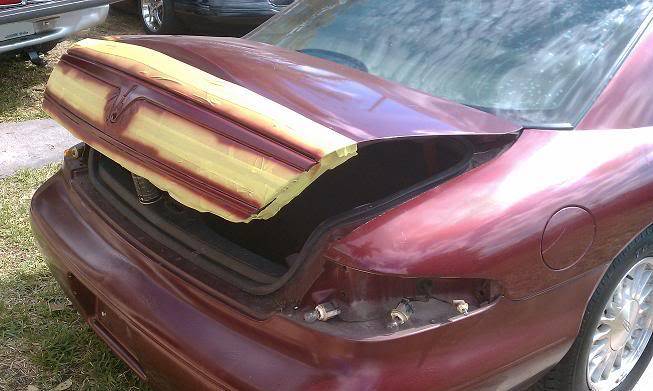

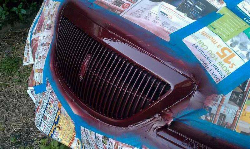

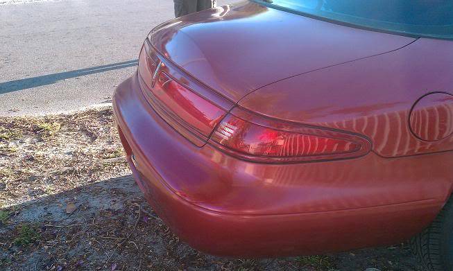

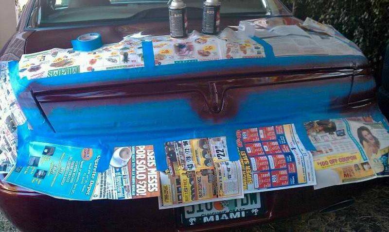

Painted the following:
Trim on this base 97
Grill & light trim

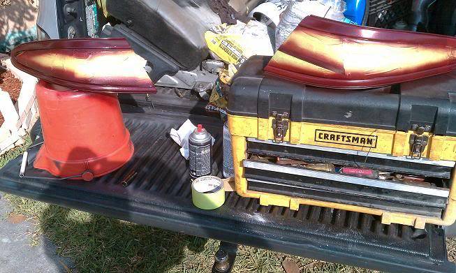

Rear neon & passanger side light
Rear neon & both rear lights

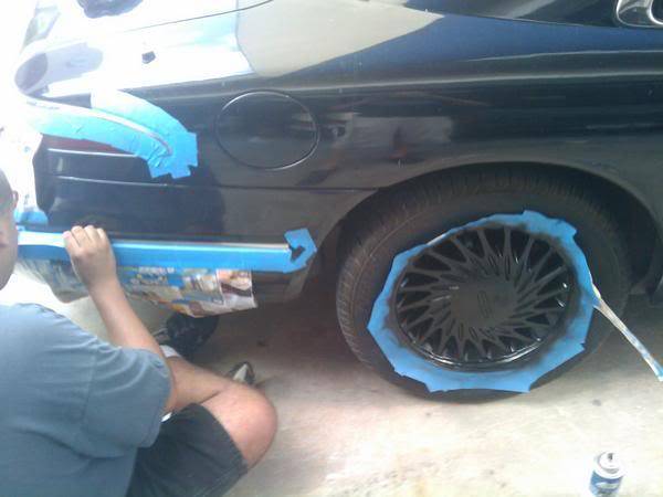

When I purchased my 93, I did the following:

Wow! That looks real good! Should bode well for me being that I used to "tag" as a teenager, although I haven't used a spray can in a long time... In any event, I really would like that LSC look on both my Marks, especially my BA Mark since that's my current baby.
Do you know if all Light Prairie Tan cans the same color or are there some that appear more darker/lighter than other brands? I'm thinking about getting this one from Autozone.

I see we both share the same color. Yes, that's what I purchased. It's the same for Advanced Auto Parts as well. BFM0346 is the famous #. 2 coats of primer, 3 coats of light prairie tan & 5 coats of clear. If you want it done properly, after the 4th coat of clear, do some light sanding then spray 2 more clear coats, super light sanding then buff. Should have a beautiful shine!
Just FYI, the Lincoln Star on the grill is an 11mm, you can remove the nut with just a socket...less to tape off :)
Yeah kinda, some people have the idea that it doesn't come off, and it's stupid easy, not even that much of a squeeze. In actuality, you probably used more energy taping it off than just removing it
Truth be told, yes, you are right... You want to know why it came down to tape that day? I didn't want to go back in the house to get the socket I needed, lol. :D

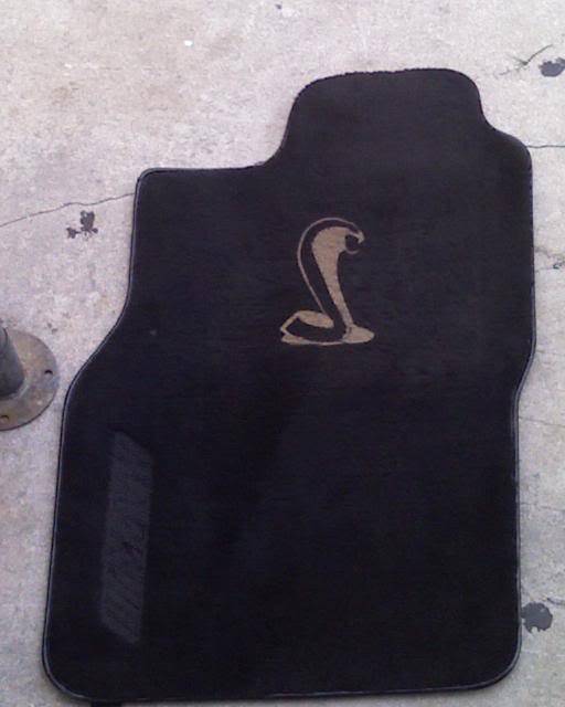

lol, that's alota spray painting..and don't tell me you painted your floor mats??

Yes, same goes for all the trim around the car. I'm re-doing the rear trim on my 97 tomorrow to match it better.

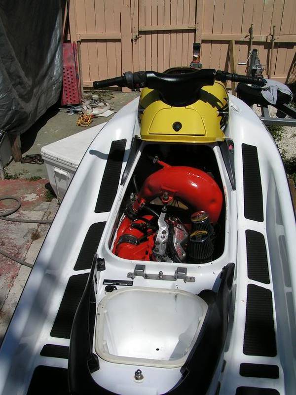

tell us more about the gp800. i can at least see a head and what looks like some double pipes? what are (or were) the mods 0n that beast?

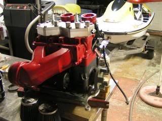

That was actually a GP760. Here's a pic of the motor before I did a top end rebuild.

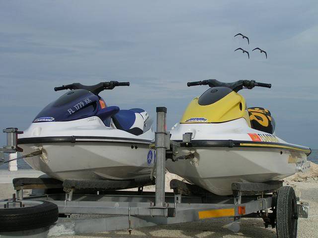

I went with full RIVA Racing parts. This was a stock 43mph ski. I turned it into a 59mph ski. It kept up with all the 1200cc big boys. Now, I also had a GP800 bored out & pretty nice looking as well. Here it is next to my GP760.

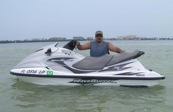

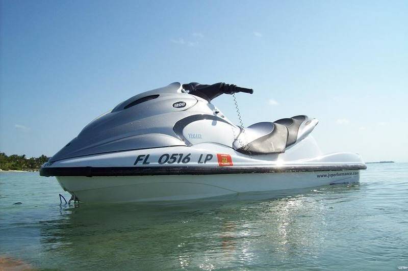

I had one ski before those 2, then I sold the above 2 skis to a guy that openened a JetSki rental place in Costa Rica. So those ski's are long gone. Then along came the monster. My pride & joy. The one I regret selling so badly!
This is what she looked like stock. Plain ol' 56mph 1200cc waverunner. She spent 2 years like this with me until I blew the engine while racing a guy on a flats boat & another skier.
I promised myself I wouldn't touch it until I would be able to come back strong & boy did I... My grandpa died that same year so I put the project on a back burner. The whole story is on the jetski forum I used to frequent.

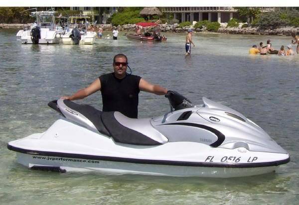

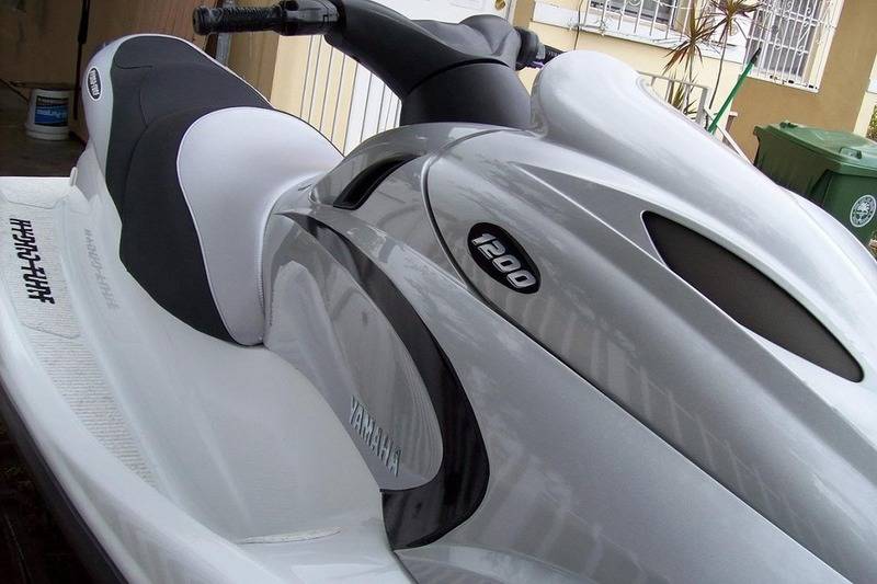

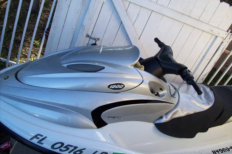

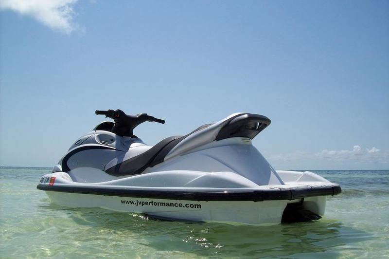

This was exactly 14 months after the waverunner sat dry. A new look, complete rebuild, 68.7mph. The amount of upgrades I did to this ski is insane. I'm not even going to list them here because no one would understand.
I took these pictures while I was installing the seat covers.

Well, my ski's were fast for their days. My GP760 was a 97, My GP800 was a 98 & my XLT1200 was a 2001. I'm not a Honda jetski guy. I've owned SeaDoo's & YAMAHA's. I stayed with YAMAHA's because they were really easy to work on. All my ski's were 2 strokes. I'm assuming your Honda is a 4 stroke as all newer skis. Much faster, much more efficient ski.
As for my mods?
*Jetworks kit
*D-Plate
*R&D Intake grate
*R&D ride plate
*5 degree GPR nozzle
*Cut out syphone intake tube
*MIkuni Racing carb kit
*RIVA Racing air filters
*RIVA free flow exhaust
*Pump Plug KIT
*TDR waterbox (on & off, depending on what I was doing)
*Stainless Steel SOLAS 13/19 pitch impeller
