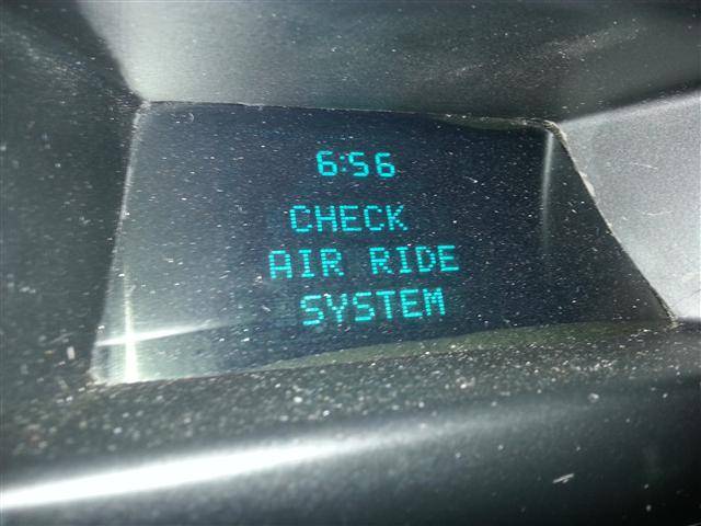

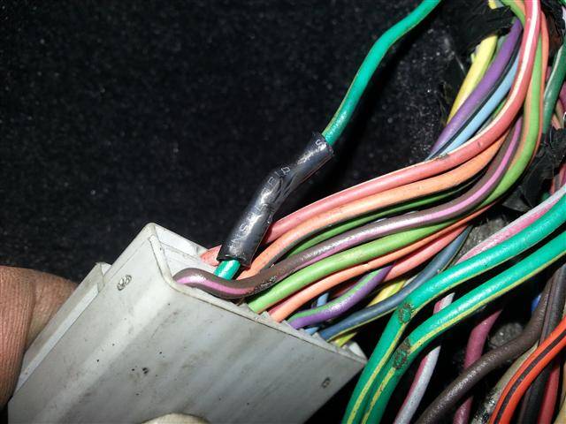

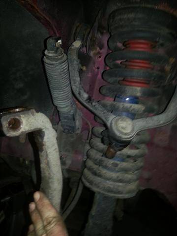

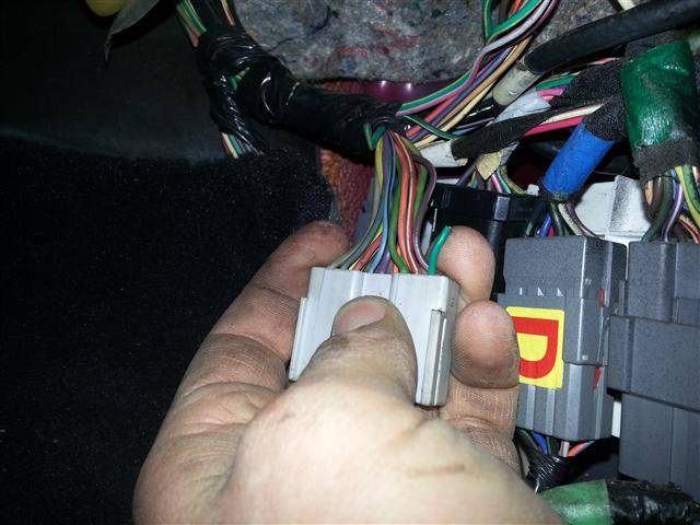

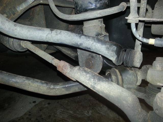

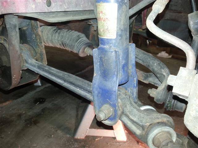

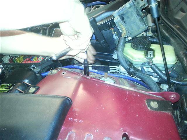

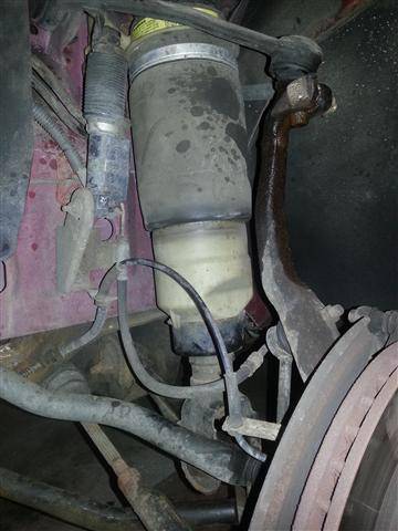

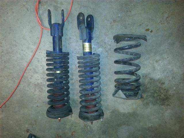

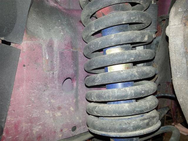

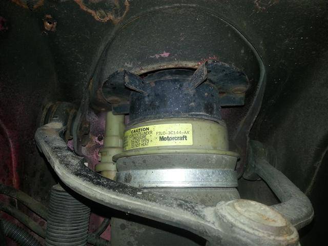

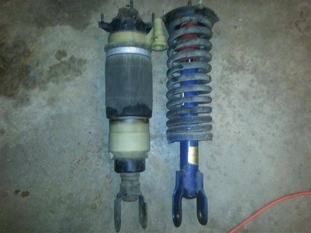

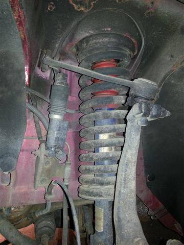

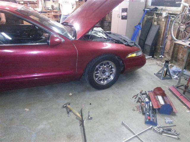

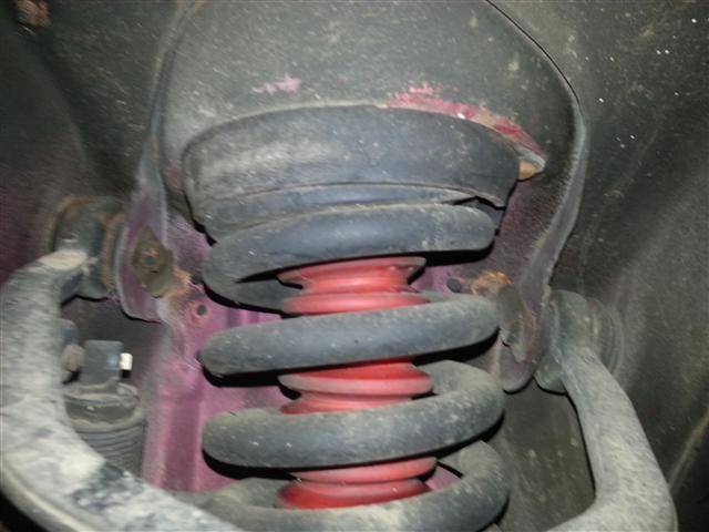

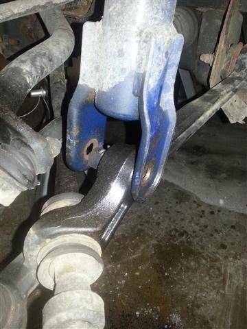

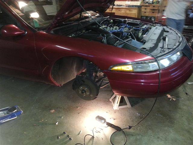

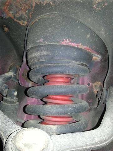

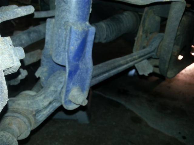

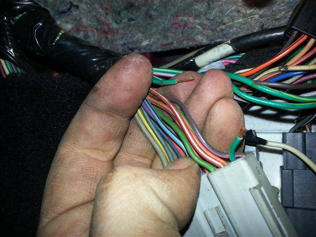

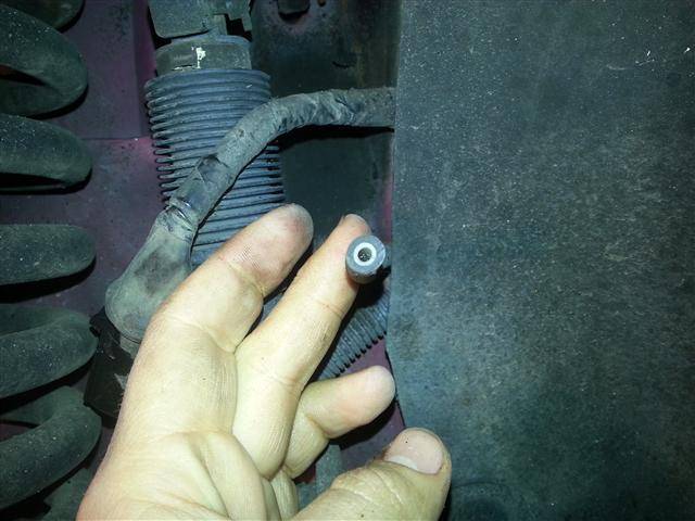

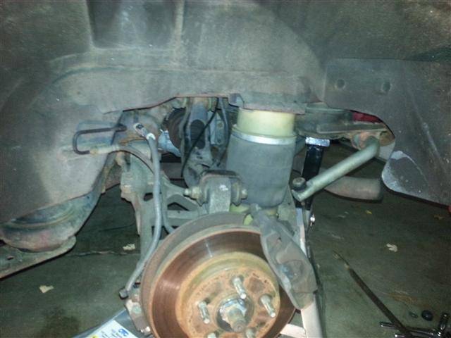

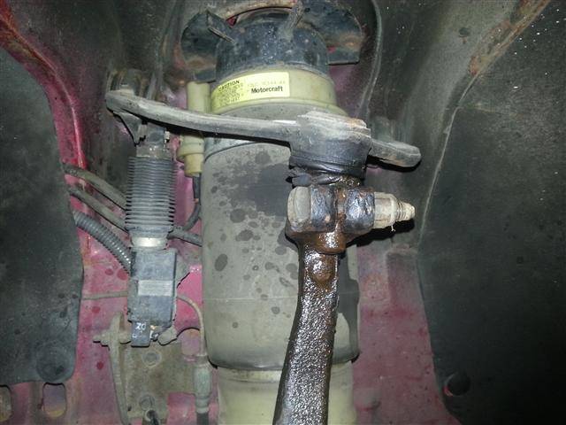

On Friday I was over at a friends house and him and Slowmkviii helped me replace the coil over susspension with a gen II air suspension I picked up last week.

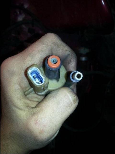

Here are a few pictures of the process. It really was not that hard we just re soldered the green wire that sent the error message, applied power to compressor to make sure air was getting sent back, check to make sure the solenoids were clicking and reinstalled the bags.
It rides so much better and It's just so much smoother!!!
The bags are from a 97 that was converted because he said "one morning the front bags where 4" higher than the night before". No cracks in the rubber and came with new shocks but I have bilstines I’m trying to get in there. It took a few ignition turns and door slams but the air system finally caught up. I still have adjusted the ride height but it nice to know I’m back on air!
