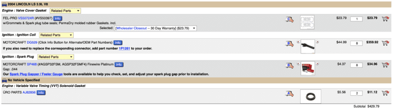

So I have these parts in my cart just about ready to check out. Am I all set?
script>
I'd say you're good to go .
Might want to contact RA and verify that the coils come with boots.
RA's pics are usually accurate... So the no boot thing might just be Amazon and/or eBay.
Get a small tube of dielectric grease for the boot to plug connection... And the coil to harness connections. Be gentle with the harness connections at the coils because they will break if you get rough with them.
Make sure you install every new o-ring that comes with the gasket set. It's time consuming... But they are there for a reason.
You're gonna need a good 1/4" drive socket set with several lengths of extentions and a swivel... And a set of stubby metric wrenches from 6mm to 13mm. The worst bolt for the valve covers is the drivers side bottom one under the brake booster.
Passenger side is pretty easy, but the drivers side requires removal of a few things to get them out of the way.... air box, fuel pressure regulator mounted on inner fender, dipstick tube, a bunch of hoses and wire harnesses. You'll need this tool to disconnect the fuel line from the injector rail, (again, drivers side):
Advance Auto Parts - Down for Maintenance
It works similar to an air chuck. From the left side fender... Pull the tool toward you from the backside as you then pull the fuel line off away from you.
I think that's all the important stuff
You also need some good medium temperature oil resistant sealant. It's required at the front where the heads meet the timing cover.
