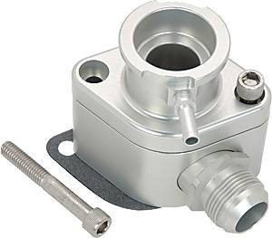

I bought something like this but I'm going to have to send it back because it comes straight off and that hits the block.. I need it to come off at a 45* then I need to go up 45*.. It's kinda tight

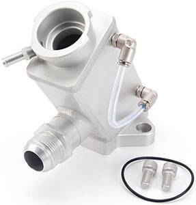

looking at your thermostat housing (replacing the existing cooling tree) just make sure the overflow teet is higher than the level in the degas tank - or your flow will be reversed.
