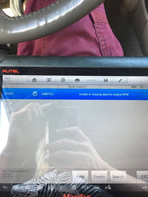

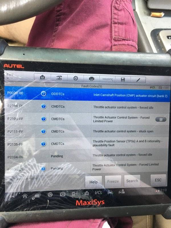

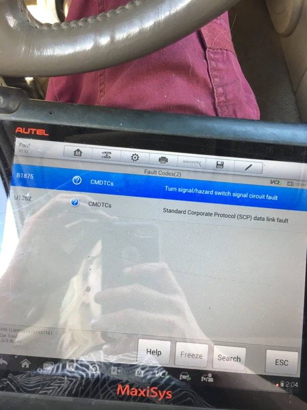

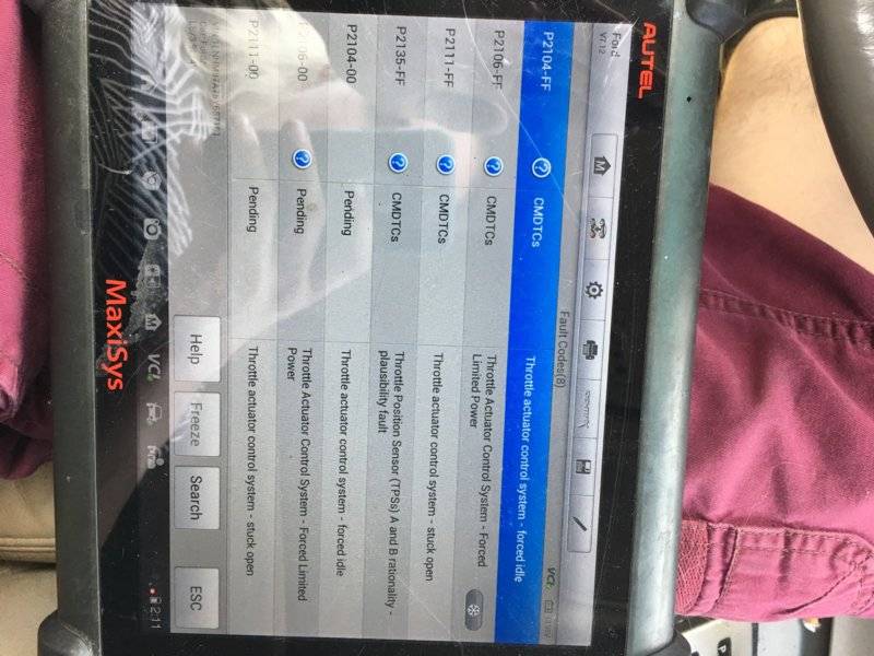

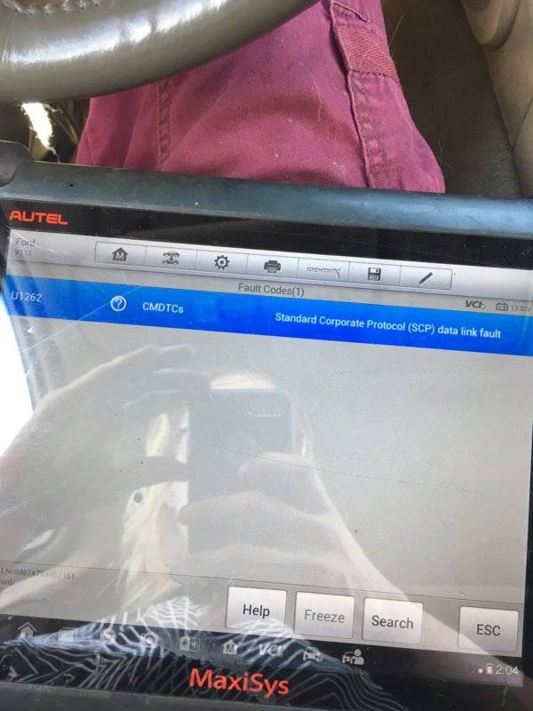

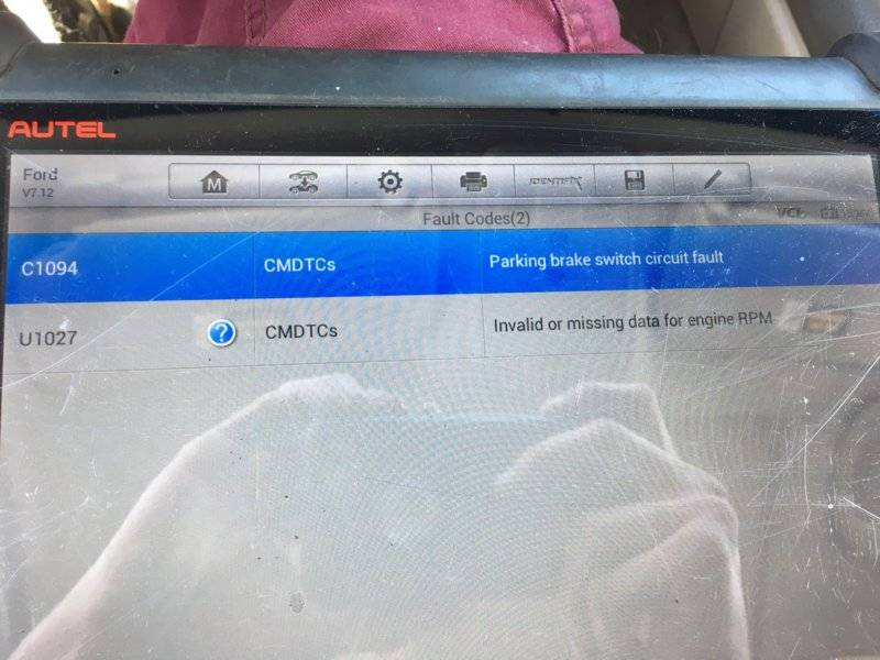

    I ended up checking the throttle position voltages on the scan tool at work and the voltages at no throttle, WOT, and the crossover inbetween were within spec. I then checked the throttle body to find it was gunked up. I cleaned it and cleared the codes but the same codes came back today. I pulled every code I could with the scan tool. Codes are c1904 u1027 u1262 b1875 b1623 b1625 p0020 p2104 p2206 p2111 and p2135. I’ll try to post pics of the codes but it won’t let me upload them. Coils and plugs are motorcraft and have 3000 miles on them. Getting 0 misfire counts so it’s probably not that. I don’t know how to check the DCCV

    C1904 is a mystery (typo?)
    U1047 - missing RPM is the source of your problem. It tripped the EPB fault, and it caused the ETC failsafe.
    U1262 - result of above code
    B1875 - multi-function switch - not related, replace multi-function switch if you are having a problem with the turn signal. Otherwise, ignore it, it could go for several years before actual failure.
    B1623, B1625 - door keypad light - not related. Does the keypad on the door light up when you press a button? - are these typos? They don't show up in your pictures, and there are codes in the pictures not in your list.

    C1094 - You didn't step on the brake pedal during the self test.
