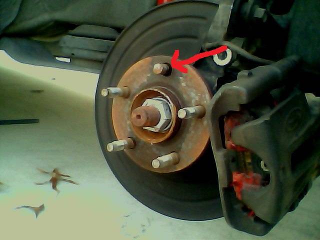

You know where you put the lug nut on the wheel,(I don't know what its called...screw maybe???)how do you replace that because it broke on my car. Do you just hammer it out?
lol you mean the lug??? One way is to hammer it out and install a new one by using the lug nut to pull it up tight but be careful you can strech and snap the new lug if you use an impact wrench and try to get it on like rambo. The other time consuming way is remove the assembley and use a press to pop the old one out and press the new one in but not many people have the time or the tool to do that.
Thanks to both of you. Got the old one out and went to Advance A$$ to get the new one twice but they gave me the wrong one both times. Had to get the car put together again without the wheel stud because I need the car tomorrow. Will get the part from Lincoln dealer and get it fixed up.
