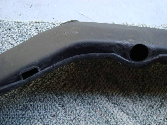

This is what I done.
Started with this.

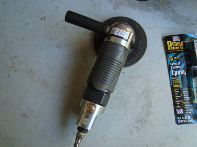

Used this to cut off what needed to be cut off.
Chopped it off.

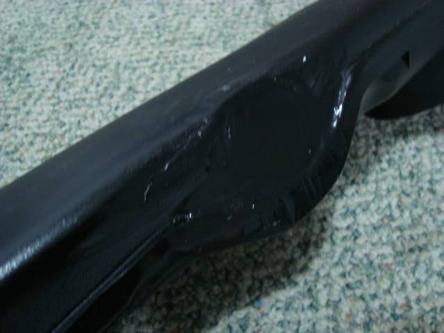

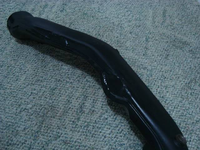

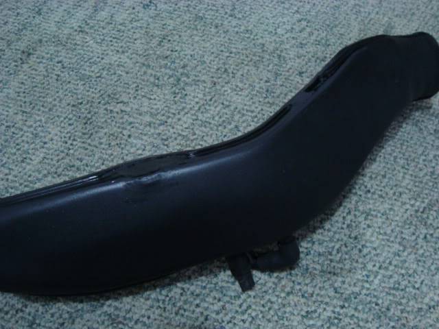

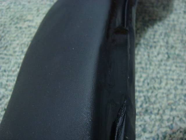

I used the General Purpose epoxy in the pic up above. I put Gorilla tape on the back side of the holes and then stuffed a rag to use as a backing. I filled both holes, let sit over night and then sanded down kinda smooth. Wasn't really concerned with it looking perfect. Painted the spots black because the epoxy was clear.
I cut out pieces to fit the holes from the scrap pieces then epoxyed them. After the epoxy dried I put some silicon on top of that to ensure no leaks. Once everything dried I used automotive bondo to make the smoothest possible surface. Then I painted it of course.
