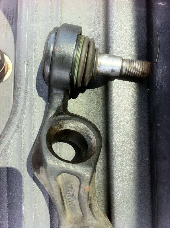

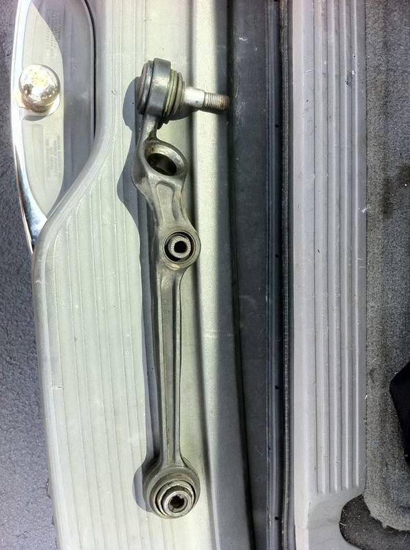

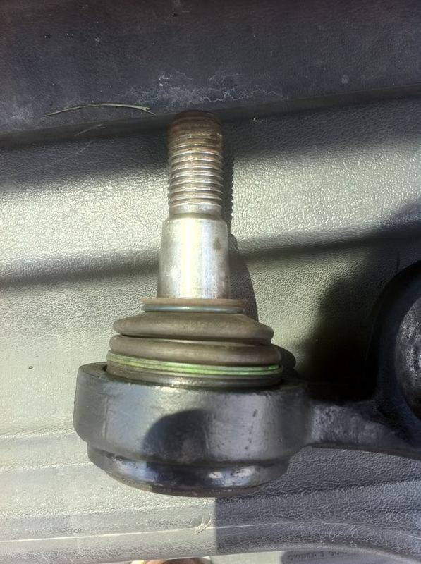

So, I have a JY control arm out in the car. We are at the doctor's ATM so I can't get a pic, but it is a newer TRW arm with a TRW non greasable BJ. I was going to put my Moog BJ in it, but the boot and the joint don't seem very old. I'll post up pics in a few, just looking for opinions...
Don't do it, like laser posted if its tight just install it.
The problem with your Moog ball joint not pressing into the arm could be a bad Moog ball joint, Diameter too small.

I would take a Mic or a dial caliper and measure the Diameter of the ball joint and compare it to a stock one before I would think of installing it in that TRW arm.
If it's undersize, return it and raise hell.

I was going to use the arm as it was, however I realized that when I smacked the ball joint with the hammer with the nut on it, I hurt the top thread a little bit. I could have fixed the threads, but that meant extra driving for a tool, so I just pressed the new Moog joint in. It fit tight as it should have. I have never used the press with hand tools, I have always used a 1/2" impact wrench. Anyway, I have found that while turning the press tighter, smacking the bottom of one of the spacers with a hammer with pressure on it would move it a few thousands of an inch each time.
Above is a pic of the joints side by side. The Moog has always been a monster, not sure why. And, these strut rod bushings are absolute garbage... the more I try to massage them to go on the sleeve, the more they are coming apart, these are going to be replaced before the end of the month. And on that note, I see Moog has come up with a different designed strut rod bushing...
