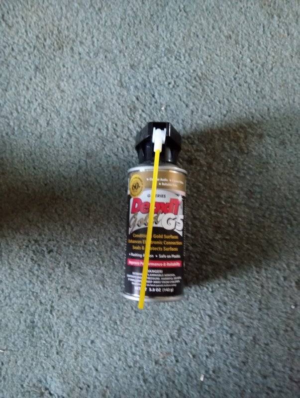

Sweet. The volume knob in particular was the real problem there. Any input from the volume knob results in my ears getting blown off. But yes, I'll have to try that on a couple of things. I appreciate the recommendation guys.
Note that Deox G5 is the weakest of the sprays. Unless you know that the contacts are gold, it's not the best one to use. Deox D5 is the best in general, Deox F5 might be best for the volume control.
If the Deox-it doesn't work on the volume knob... give it a right cross or upper cut. ;)
Noted. I'll give it a nice little jab if it decides to bust my ear drums again after the F5 spray.
