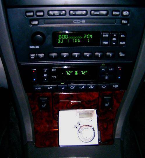

I have an '02 with the built in 6disc. My adapter has worked fine. Sucked to install, but works great.
