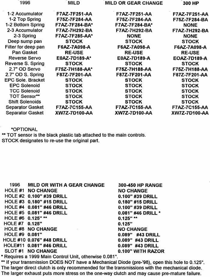

also, anyone have a link for a how to for the j-mod?

PM me your email address and I'll send what you need for the J-Mod. You'll need the two gaskets for the valve body and a 3/32 & 7/64 drill bit but all of that information is in what I'll send to you. Don't put your email out to be spammed. Please PM it and I'll get it right to you.

these should ya out...everything u needed to know about the jmod...congrats on the new mark and welcome to our forum. Also remember you will be drilling through the seperator gasket and NOT the valve body
The info I sent him is correct in PDF format and anyone that has done a J-Mod would know that you don't drill the valve body. Your info that you posted is for 97 which is different from the 98 and will require different drilling points. I know this because I have done it. Not quite as many holes to drill for the 98 and it only needs two different sized bits. He also didn't buy the car yet. Notice the header???? Before posting J-Mod info, try and be sure you're posting for the right transmission. Apparently you didn't know that things changed in 98 for that particular trans. That's why I chose to email the info. I emailed info about a 98, not 97 and older. Don't want people getting confused that don't know about changes.
