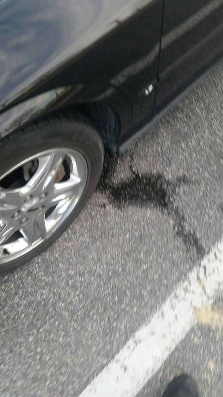

Driving to and from work the next day... literally driving there and back because work got cancelled. .left me with this once I got home... stopped at lights, cut off the car.. kept the car moving...
so what your telling us is that your (recently) un-pressurized system is still giving you problems and leaving the car loose did not fix your issue?
No one is surprised of this...
In fact this is what you were told would happen until the car is properly fix AKA replacing all of your worn out plastic cooling parts.
So either get used to not being able to get where you need to go, or replace all of the plastic cooling parts.
