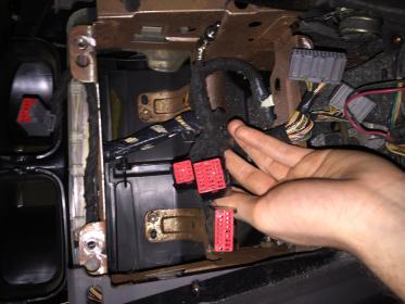

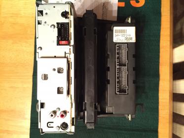

About to start splicing the new harness in but just want to make sure I'll be doing this correctly.
What's got me questioning the install is the two plugs on the right, will I be able to just splice the new harness into the corresponding wires on the recantular harness and leave the other two unplugged since there's no where to plug them in or do I need an adapter for them?
Not worried about steering controls or the 6 disc in the glove box. Just want to get the new head unit installed to run with the factory amp and subs.
The subs are on the 8-pin connector. You'll need the correct harness that includes the mate to that connector. You'll also need a 2K ohm resistor to wire in series between the remote amp turn-on signal from your aftermarket unit and the signal to the sub amp. Otherwise, it will pop on turn on.
So something like this as well as the resistor? Where exactly should the resistor be wired in with this harness?
https://www.amazon.com/gp/aw/d/B000YR6C2E/ref=ya_st_dp_summary
exactly like that...
the resistor goes in series between the amp turn on wire coming out of the radio and going into the amp turn on wire going into the harness,, the amp turn on wires are usually blue/white, however on some cheap radios that are not worth installing, it may be just blue (note that some radios have both a blue/white wire and a blue wire, in this case they are different)
Thanks for the info. The harness that came with the JVC unit pictured above had a label on the blue wire denoting that it was the amp wire, feel like I've got a pretty solid idea of what to do now.
