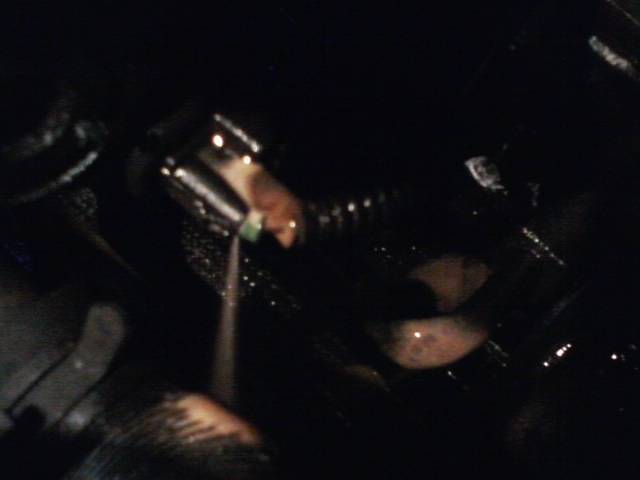

This is a photo of mine, squirting from the power steering pressure switch:

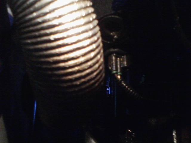

The electrical wires that go into it are easier to see here:
Right behind the green area.
Looks like a fire waiting to happen.........
