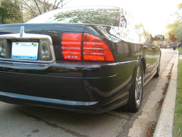

I notice that you are also driving on 255/45/17 tires. Are you having any problems with them as they are much bigger than the 235's. Also do you have a picture to show me what they look like

Here are teh 255/45/17's with a 2 inch drop, there is no rubbing at all, just all traction!

I will try to get picture soon on my 2004 V8. Has stock 17"X7.5" aluminum wheels. #3415 Hollander wheel one location online stated. The Continental "DWS" 255X45X17 tires work beautifully with good stock suspension. I did replace front sway bar links with Moog LS specific parts and Energy Suspension black poly 30 mm front sway bar to frame bushings and brackets that come with kit. LS rides super and handles well overall. Speedometer is less than 1/2 mile per hour off at 70MPH, when says @70 mph car is really doing 69.67 or close to 235X50 stock tires. Tires are near 3/4 inch wider but no rubbing or touching anything on car. I was wondering what an inch shorter spring set would do for cornering but heater repair stopped that idea for now.
