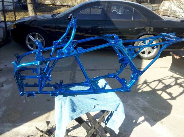

Just curious if anyone on here is into powder coating. When I get home I'll throw up some pics (I know how you all are!) but I was just wondering if anyone else was into the hobby / addiction.
Pic is from my phone. This is my Banshee frame, actual reason why I got into this. (please no comment on how bad the LS looks....Its been washed several times since)

and like you can see, I had no problem with my banshee frame, nor do I have an issue with most motorcycle frames.
