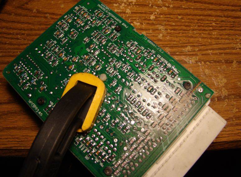

I took the Module 8 out of my red Mark when I parted it out. I also took the air ride module, harness, and plugs.
I want to use the module in my black Mark in the winter, and in the white Mark in the summer (the green Mark already has one).

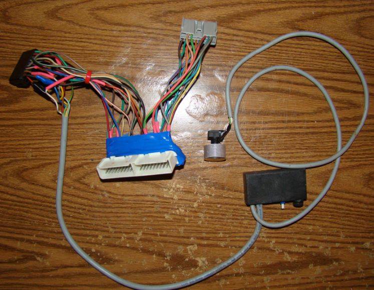

Since I hate connecting the wires in the car (it's a pain to get to) I rigged up a harness to just plug in.

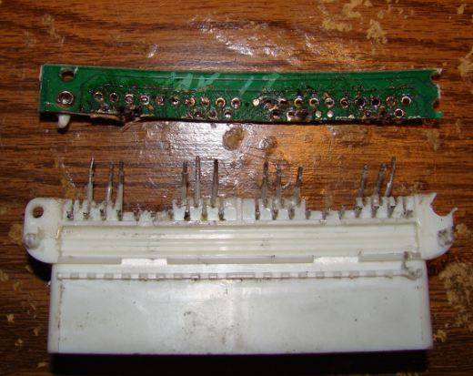

I cut the male plug out of a spare air ride module, de-soldered the pins from the circuit board, and soldered the wires from the harness to the pins. I used shrink tubing and sealed it all up with hot glue when I was done.
It's not pretty, I left the wires separate, as I'm not sure how much room I'll have to work with in the car.
I'll try it out later this week, here's some photos:
