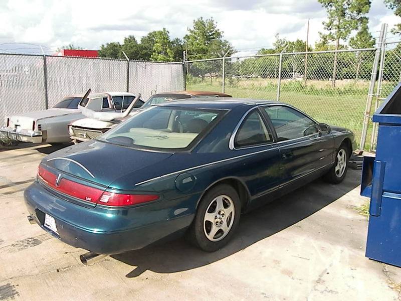

What is the best way to remove the pin striping? It's the sticker pin striping and has been on for a while.

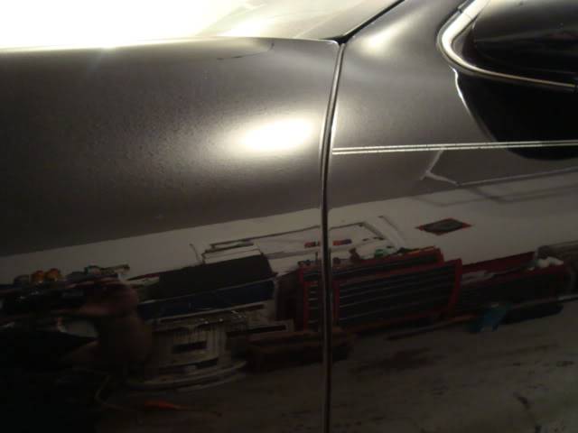

GMAN, the eraser disc is what I used and it worked perfect. Couple of pics below show the proof. I used it in a high and low speed cordless drill. You might go through 2 batteries doing the whole car but once you have it off, come back across what you done with an orbital buffer and a light compound just to clean the residue off. Turns out good and I done my whole car in about 45 minutes.

Those look like painted on pin-striping.
no those are vinyl, an eraser wheel won't take off paint. If the stripes are old you'll prob have a hard time with a heat gun cause they will continually break when trying to peal them. An eraser wheel is the only way to go. As long as you don't spin it at an ungodly rpm it won't tear anything up.

Yes, keep it moving back and forth and don't stay in one spot. I never burned one spot in the paint using the wheel and it doesn't matter if it's painted or stick on, the wheel will remove them. I have used it on a truck too that had them painted on and worked good with that too. It took more time and the painted on type created a lot of dust but it did take them off.

just be careful, mine had stick on stripes, and as i removed them i learned that it had painted on ones underneath, at one point that were semi removed than the car was re-cleared or something, cuz on my driver front fender and some of the door i have ghost stripes under the clear coat...
