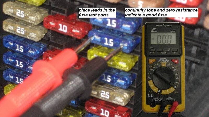

You can check those blade type fuses without removing them from the car. Very simple and quick.

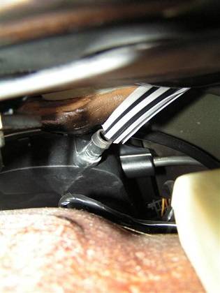

Also follow joegr's suggestion about the sunroof (moonroof really) drains. Very common and no cost to fix if you can DIY it.
Here is what happens.
I pulled my up and used a hose clamp on it to prevent it coming off again but the tubes do shrink and several people have needed to add a short section of hose to reconnect them.
