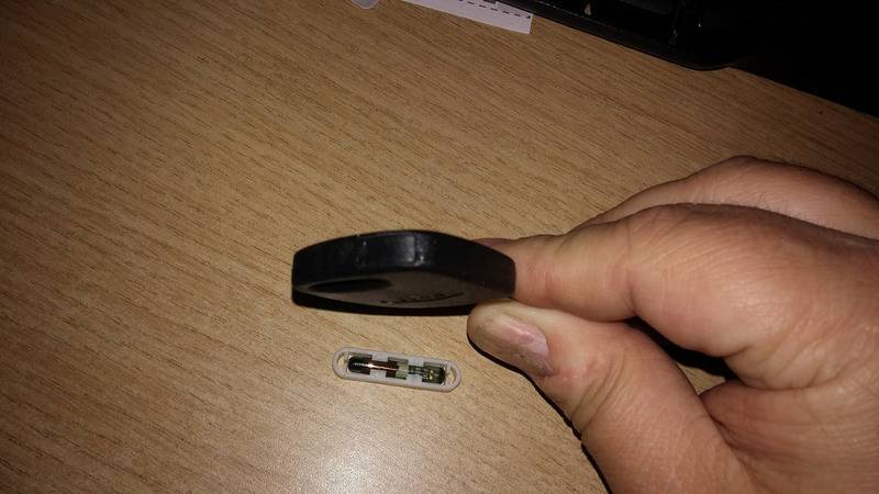

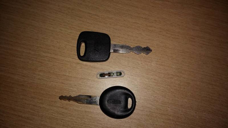

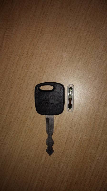

chip from a key that works with my 2000 Grand Marquis:
obvious cap where chip is in head of key:
