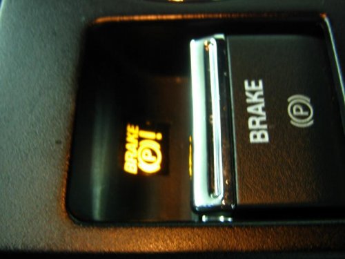

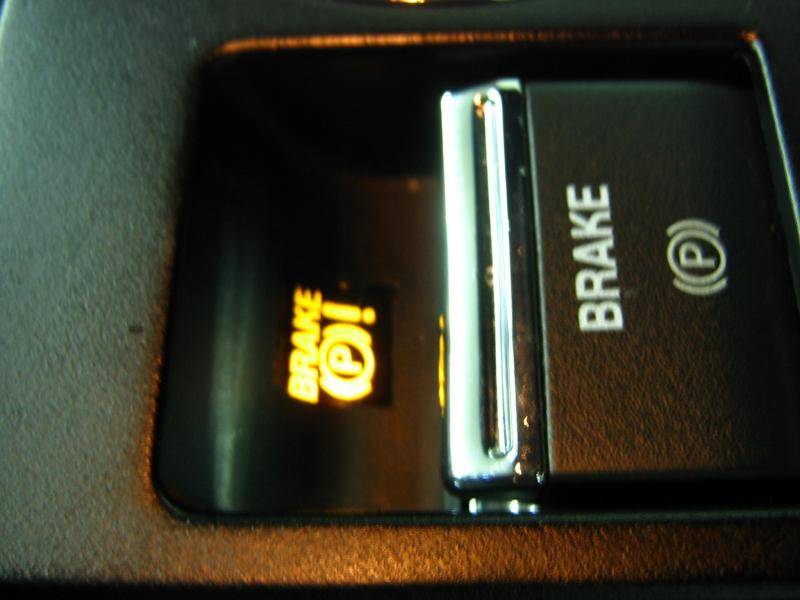

what the hell could be causing my e break light/service (P) to turn on The parking break works when i press the button i can hear the breaks come on The light it not on all the time just sometimes

The brake light and the service parking brake light are two different lights. I assuming when the OP said service parking brake light, that's what he meant.
Brake light = red light on cluster = parking brake on or brake fluid low
Service parking brake light = yellow light on console = problem with the electronic parking brake on gen II

Unlikely. A fault with the switch can cause the light to come on. If your switch isn't physically broken, then it's probably not the problem. The parking brake module would be more likely to be the problem if the parking brake cables are okay and correctly attached to the calipers.
