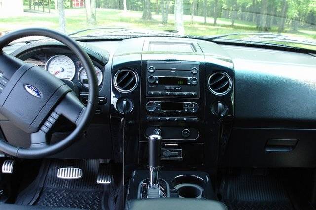

I used spray on paint stripper in very SMALL amounts until that rubber was gone. I then sanded it with some 1000 and sprayed bulldog adhiesion promoter then paint and clear.

Whats with those ricer (go fast) pedals?
Here we go.
Just because they are aluminum they are RICE!! You like what you like and I like a look that I like. Actually Ferrari porsche and Lambo's had these since the 80's LONG before any "rice" did. There extremely grippy and thick, they feel good at the foot and look better then plain black boring rubber.
