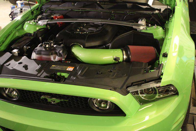

Looking to color match my K&N Typhoon intake to dress up the engine bay a bit. Saw it here:
And it sort of got the creative juices flowing.
So i'm looking for opinions/advice...I don't want to powdercoat, so don't suggest it please. I want to do a quick/cheap mod.

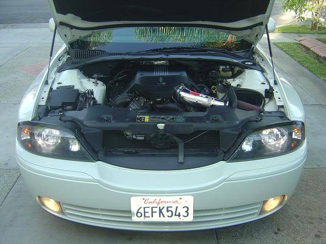

Not my pic(sorry Alex), but pretty much how my engine bay looks now:
Scuff it up, prime, paint & clear with hi temp. That should last you awhile on the intake tube. You might need an adhesion promoter for the engine cover.
