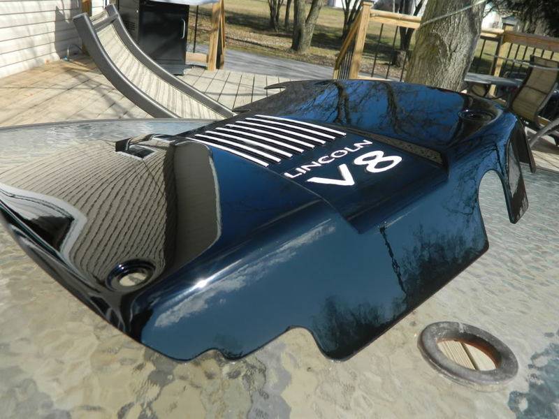

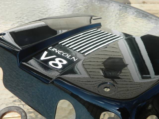

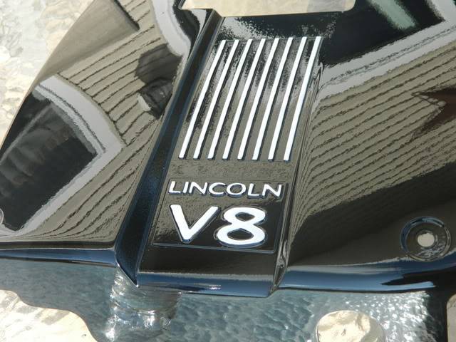

what do you all think? i didnt want to do black because my whole car is black but i do like the way it turned out. Next is to do my air intake to match...maybe with some kind of lettering on it. anyways check it out...
it is still a little wet and ill need to wetsand and buff it later.
Very nice! Did you sand it down at all?

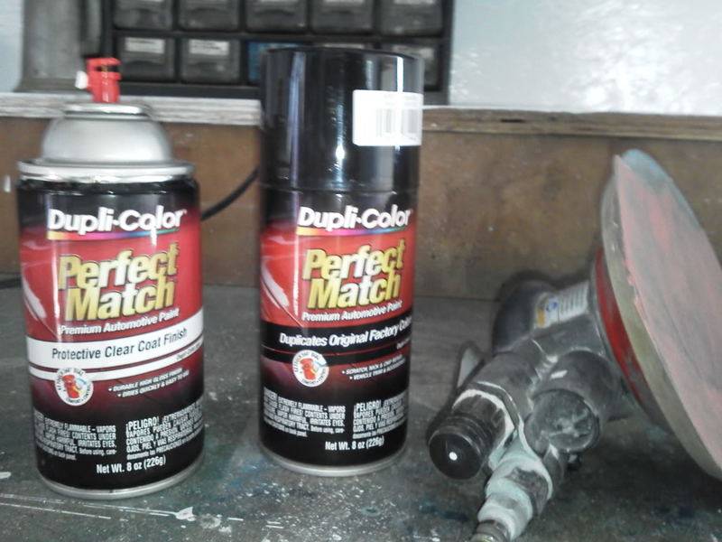

i sanded down the rough texture with a DA sander with 220 grit. then i sprayed the first coat of primer then wet sanded it, then put two layers of paint follwed by wetsanding, and just layed down a thick layer of clear and havent sanded that yet...all was sanded with only 1500 grit wet paper and sprayed with duplicolor from autozone.
