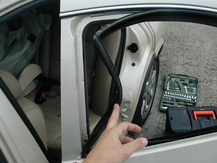

im looking to replace my driver side rear door pillar. as its bent in, from an obvious tool used to pry the driver side door open. maybe the previous owner locked the keys in the car or its been broken into..
anywho.
my question is.. why take the door panel off, and detaching the window motors and stuff? it looks like a simple, pull off the door trim, slide off the weatherstripping, and remove the pillar panel and replace. are there actual screws holding the pillar panel on or something? im a little confused.
.... my question is.. why take the door panel off, and detaching the window motors and stuff? it looks like a simple, pull off the door trim, slide off the weatherstripping, and remove the pillar panel and replace. are there actual screws holding the pillar panel on or something? im a little confused.
If you look closely there are screws behind the weatherstripping, looks like three of them.
Without the glass being able to drop all the way down you will have a hard time loosening the bottom screw.
Good luck.
ahhh!!! i see now, crikes! more workk sheesh. lol, big thanks for the tut its gonna come in handy ;)
I've had the door panels and window bits out several times....it's not hard at all and very simple.
