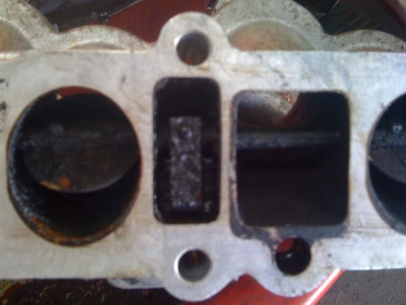

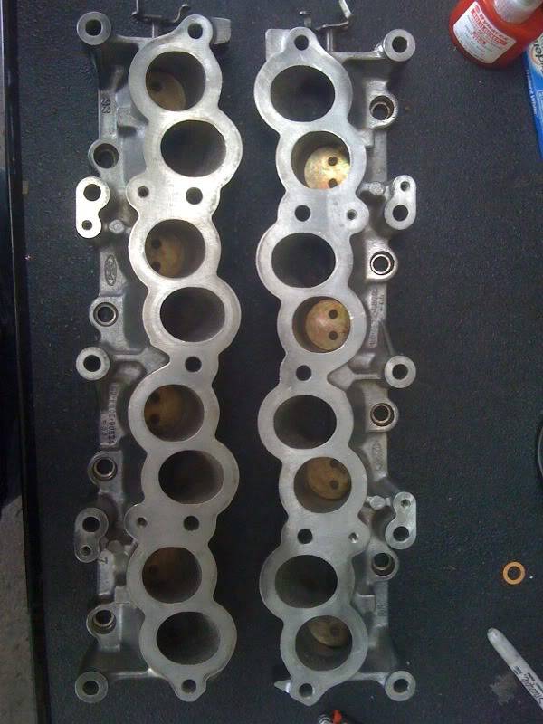

Nasty IMRCs are SO fun...the intake really isn't that big of a deal to R/R...however when you clean them, use an intake/throttle body cleaner so you don't damage the seals on the ends where the actuator rod comes out for the vacuum solenoid
here is one from a 120k motor
when you remove the solenoids, check them with your mouth, just suck on the little stem, there's a diaphragm in them that catches the vacuum and activates the rod
Once cleaned they should move freely and your motor will love you for it
thanks. the ones i have look as clean as the second set you posted. im right at 135k on my car so i can just imagine what they look like
