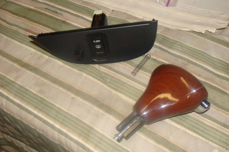

all you need is a momentary switch, on/off push button type. there is no right or wrong polarity if you touch the 2 wires together you will turn the trac control off, touch them again, turns it on, get it! i put mine back to stock but this is what i had done to install a wood knob collector edition look alike. you can find switches like these at any parts store.

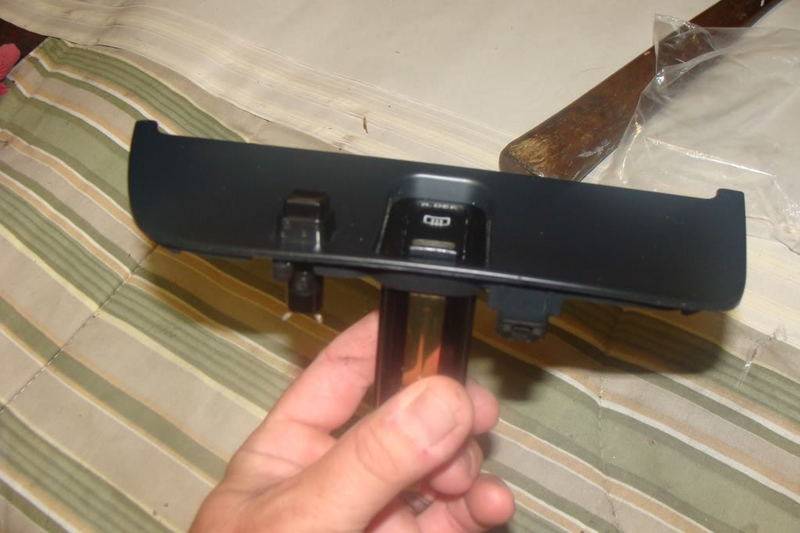

what year is your mark cuz i have that one for sale with the panel and switch you see in the picture the whole deal.
